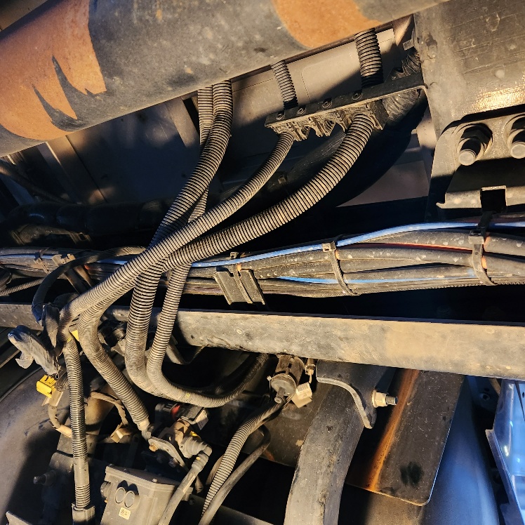

    Just filled the def tank, let the truck sit for a few days, go to start it and the "scr has been altered or fault detected derate" comes on screen.
    Got the hand held obd scanner out and it says the quality, level, and temperature are abnormal update rates, or something like that. No high or low voltages, so hoping it is isolated to the sensor, not the pump or other hardware.
    JGP had one on the shelf. I asked service how long to replace it, they said with all the pretty skirting hanging on my sleeper, it would take extra time as it is already a long procedure with the plain sleeper over the tank.
    I'm no mechanic, but can bluff my way through simple things like direct replacements etc.

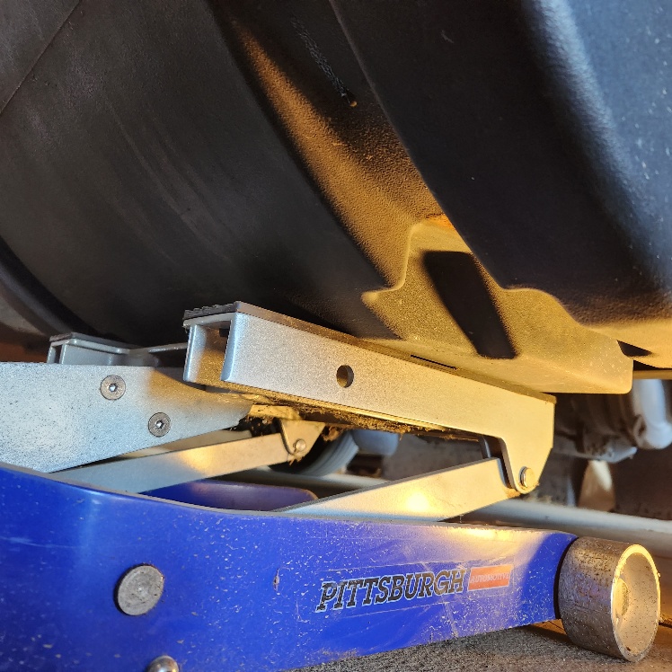

    I happen to ride motorcycles, and have a harbor freight motorcycle jack that has a nice large, flat lifting rail system. The bottom of my tank is flat, so seemed like a nice setup to try.
    IT WORKED AWESOME !!

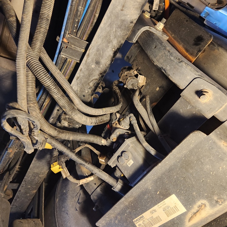

    So here are a few pics of dropping the tank after removing the straps from the support rails. Also, the only connection I had to remove was that of the new sensor. No coolant lines or def lines were disconnected. No mess, and about a 3-4 hour job.

    Nice work . did the sensor fix the problem?
  4. Deezl Smoke
    Deezl Smoke Medium Load Member
    516
    337
    Feb 12, 2011
    Hillsboro Oregon
    Yes it did. And,....because I was lucky enough to have the failure at the barn instead of on the road in the middle of nowhere as most of you will likely have, the derate was only minutes, not hours, in, so the codes self cleared. 2 cleared upon start up, and the other 2 with a short test drive to get the def up to temp and the quality sensor to have enough run time.
