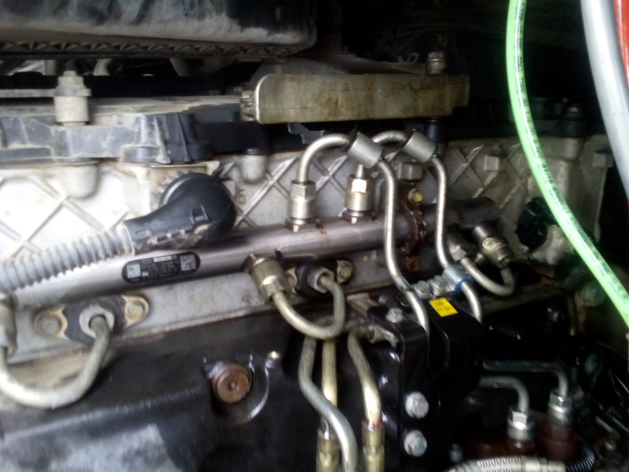

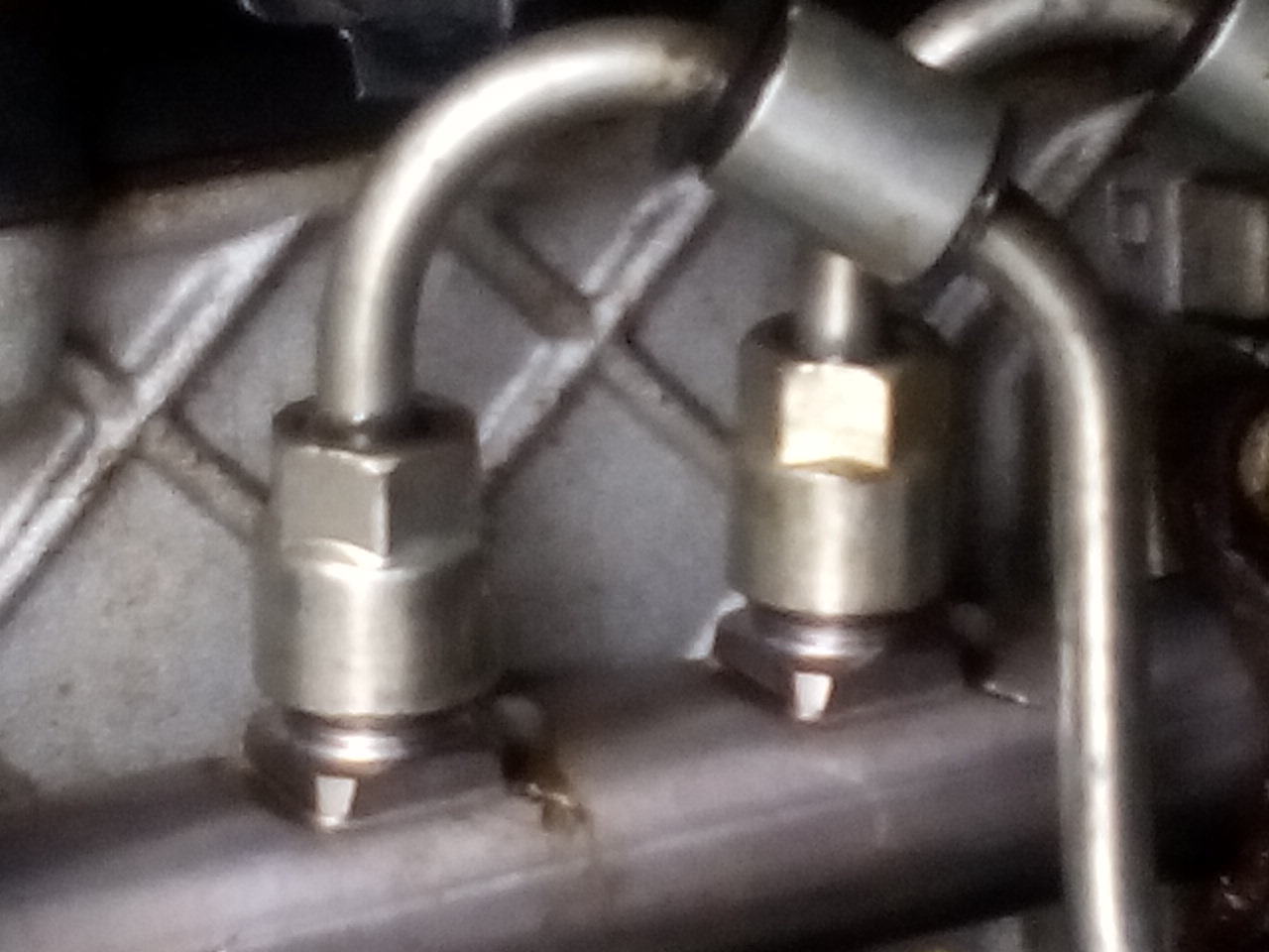

    Fuel rail is bone dry cant find any air leaks or fuel leaks atm
