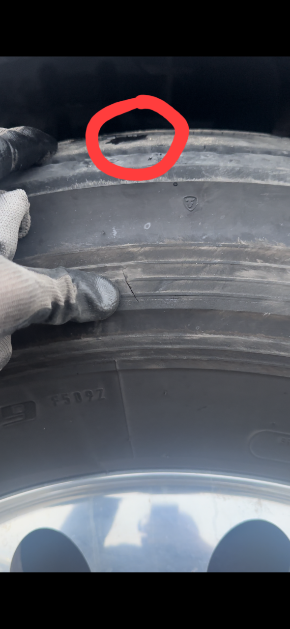

    Cut on steer tire sidewall
    Need change?

    If you can’t see the cords, I wouldn’t worry about it. I personally would run and let me say I have run one similar to yours with no issues.

    No cords

    Run it. Like mentioned, keep an eye on it. You’ll be good.

    Is that just how the picture looks or is a chunk missing out of there?

    This just oil

    Personally I would have a reputable tire shop take a quick look at it. It appears pretty minor and it’s probably OK, but definitely not worth risking a steer tire blowout.

    I agree, good trailer tire,,,I realize it's easy for me to say that, it sucks in that you usually can't just get a used replacement, like a drive tire, I've seen much worse, I suppose you can run it, see if it gets worse, doesn't look like any sidewall damage, but playing Russian Roulette here.
