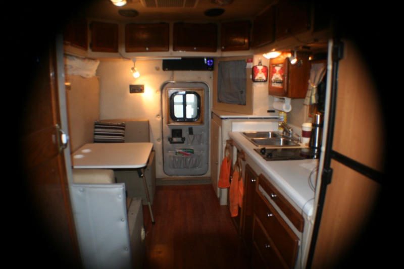

    When the wife goes out with me in the summer, we tend to take loads to special places to see and take a few days off and enjoy the area.
    Did about 15 vacations in this truck last year while getting paid to go and leave.

    Thanks for the photo Flightline..... Nice rig!
    Does anybody have one of the smaller custom sleepers? customkw.com seems to have a great idea.....Factory 86" sleeper with a kitchen, shower/toilet combo and bed. I would enjoyhearing some feedback from anybody owning something similar. Photos would be great if you did the work yourself also!

    My Last truck (Volvo 770) put a sink and toliet in it. Put the cassett toliet in the closet and the sink in the shelf under rear window.
    Hope it's big enough to see.
