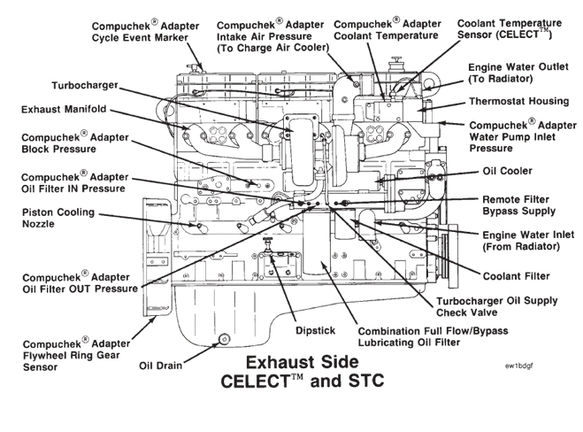

    Hello, got a Celect Plus N14 on a 2000ish freightliner FLD. Dash gauge isn't showing any water temp, and when ringing out the signal line for the dash gauge it leads to an empty connector at the front top of the engine. The water temp sensor for the ecm (which is a smaller connector) is connected to the water temp sensor and reads fine for the ecm, but where should I give the signal for water temp to the dash gauge from? That connector was just zip-tied away and wasn't connected. Made artificial signal and dash gauge is in working order. Thanks in advance!

    I've got a 97 FLD, its got an over temp switch in the thermostat housing going to the dash for the over temp buzzer and I think my gauge is fed by the ECM. How many wires do you have for that sensor?

    It has two wires. Ihave a one wire sensor for over temp light, 2 wire for water temp to Ecm and another bigger 2 wire for the water temp gauge. That bigger connector is hanging and I do not know where to plug it in

    Top of the thermostat housing according to the manual.
    Unfortunately, that is the whole diagram, here's another one with all the sensors. The one you're looking for is the celect coolant temp in the top right.

    Thanks for sending that. There was no sensor I could use for the dash gauge so I tapped off of the signal of the water temp sensor to the ecm
