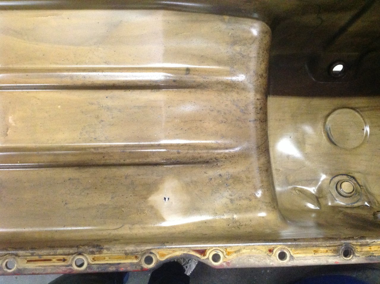

    Had a customer that had a hole in their oil pan. They patched it once and it held for a while then started leaking. They replaced the pan and 5 months later it has a pin hole in the same area. Anyone ever heard of such?

    Is the hole a small puncture, or has it rubbed through from something flapping in the wind? What does the inside look like?

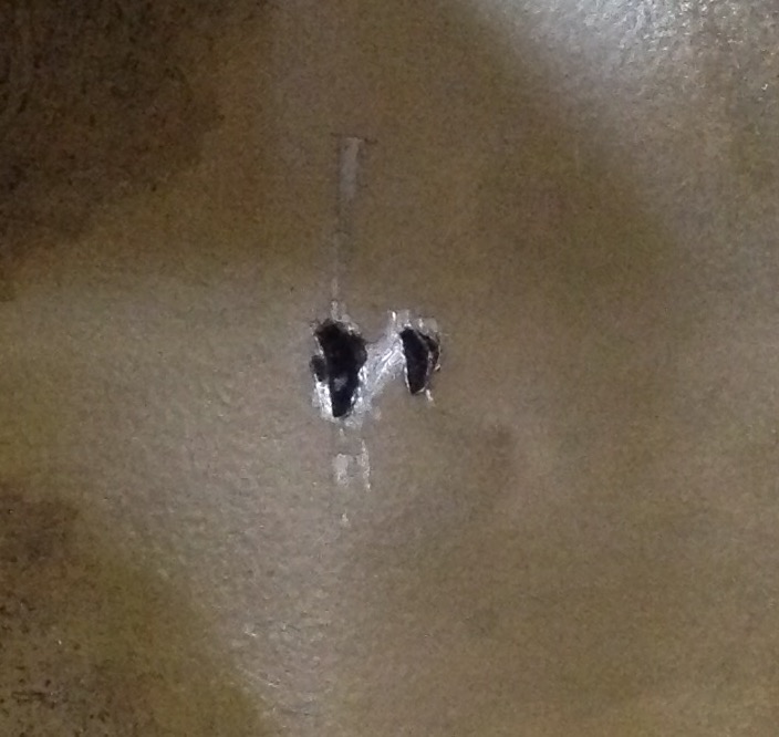

    I still had the old oil pan and took a look at it today from the inside. It looks like two pit marks. I will try and take a picture of what the inside looks like and post tomorrow. I had to leave work early today and when he came in he was in a hurry to get a load some where. I just drained enough oil out of his pan to clean it, get it dry, and buff it off. Then I put on some JB Kwik. Stopped the leak but I told him when he is due for service we need to drop it and repair it better. The last one he had his insurance company pay for. This one is on him.

    Here are a couple of pictures.

    Looking at the pics it looks like something may be hitting inside... But what? Guess I will have to take pan off and see..

    Deffinattly not corrosion. Something hit that forsure.
