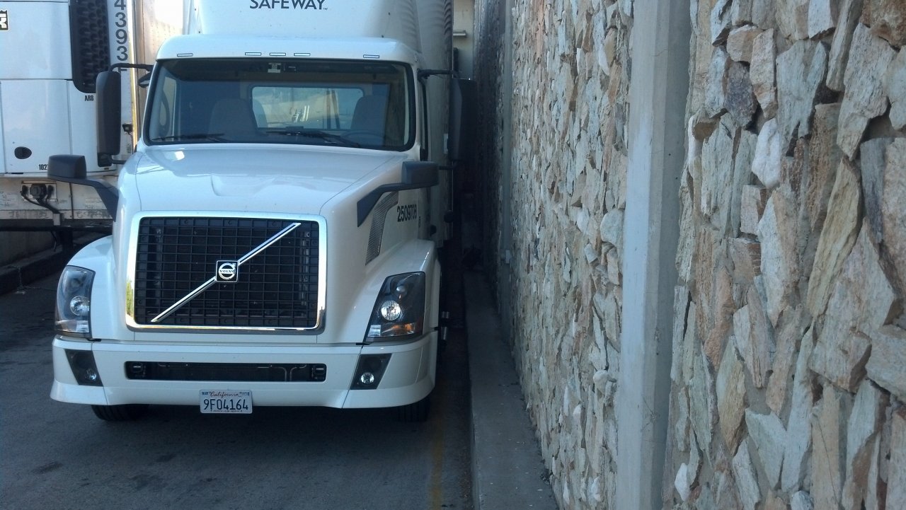

    C45914C3-9451-43A0-ADD9-404A907E9542.jpeg No room for crooked sometimes, I always just look to see if I have equal distances of corners of trailer in my mirrors.
    Lepton1 Thanks this.
