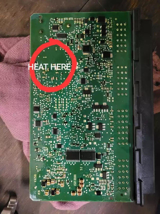

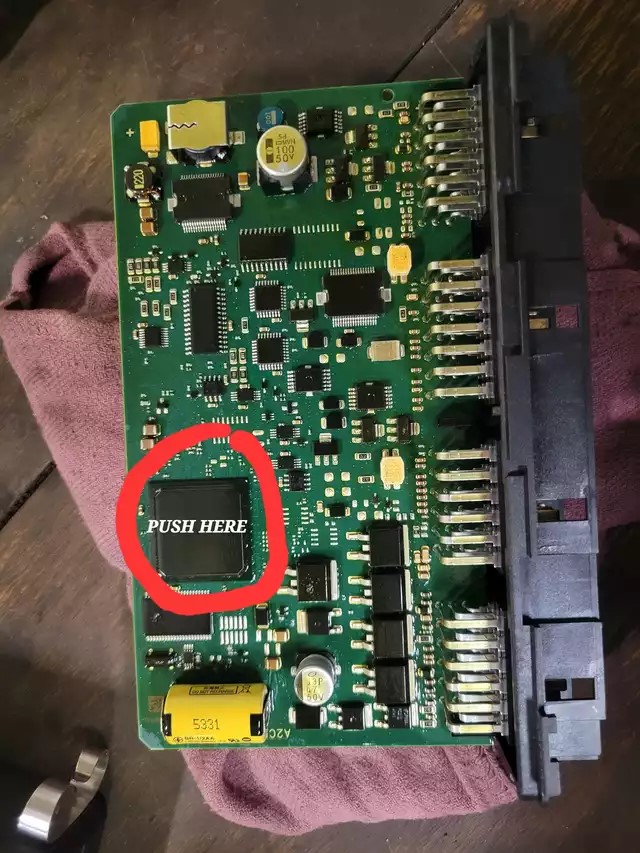

    how to fix cpc4 ?
    if you have done it please share with us what you did.

    Open case. Remove circuit board. Heat with a hair dryer, then twist the board back and forth a few times. Let cool. Plug in and try. Will work for 1 month/1 week/1 year.
    spsauerland and msh Thank this.

    i have used butane small torch.

    How hot do you get the board?

    i dont know exactly how hot must be ...
