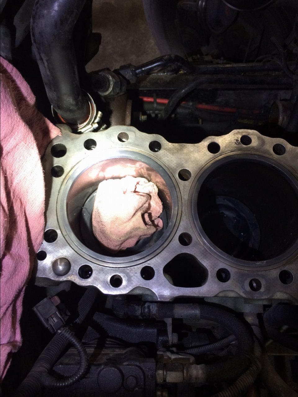

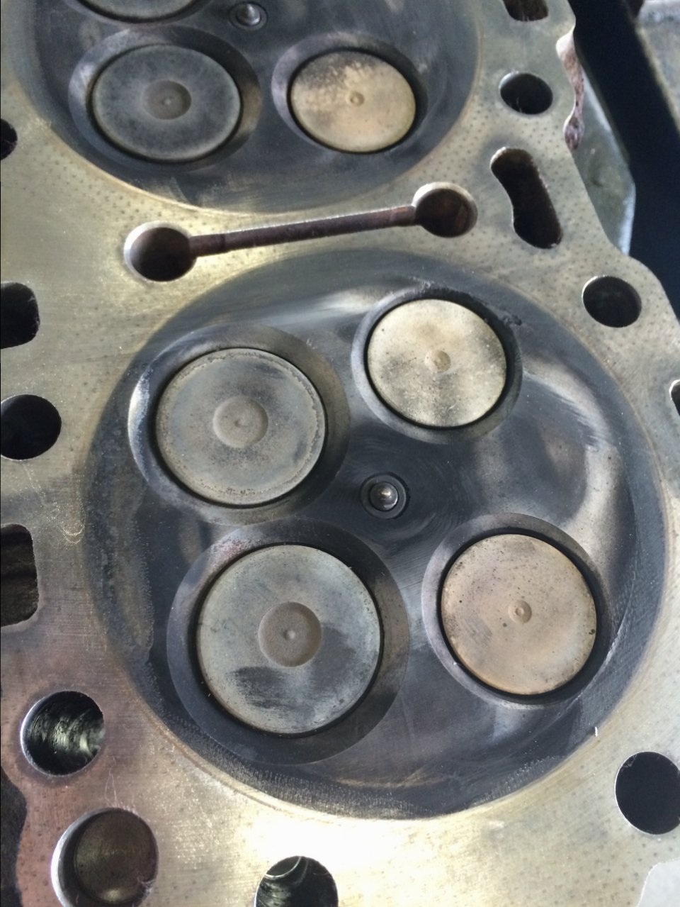

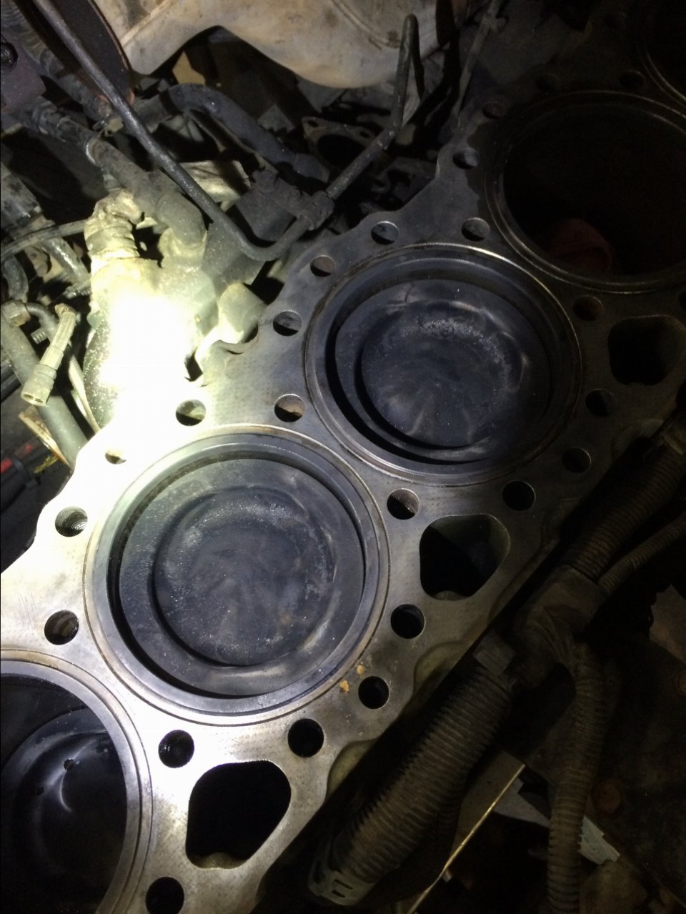

    Detroit Diesel showed me the "head off" motor today. The mechanic said: The head gasket is blown - little bit on every cylinder, but mostly on No5, cylinder liners are OK, but maybe sunk, head looks OK, but we recommend to buy Detroit rebuilt head.When I ask, if they can send the head to machine shop, they said: The original shape of the head is ark, so if you send it to machine shop, they will make it flat and more prone to failures... ????
    I am uploading some pictures, any inputs are welcome........ no cross contamination was found (oil in the coolant or vice versa). The last strange thing was, to fix the sunken cylinder liners, they must cut the cylinder block to make it the standart height ????
    This all sounds weird to me, because I did many head gaskets on small cars and if the head is not warped, you just clean, put a new gasket, maybe some of this copper spray and is good to go...
