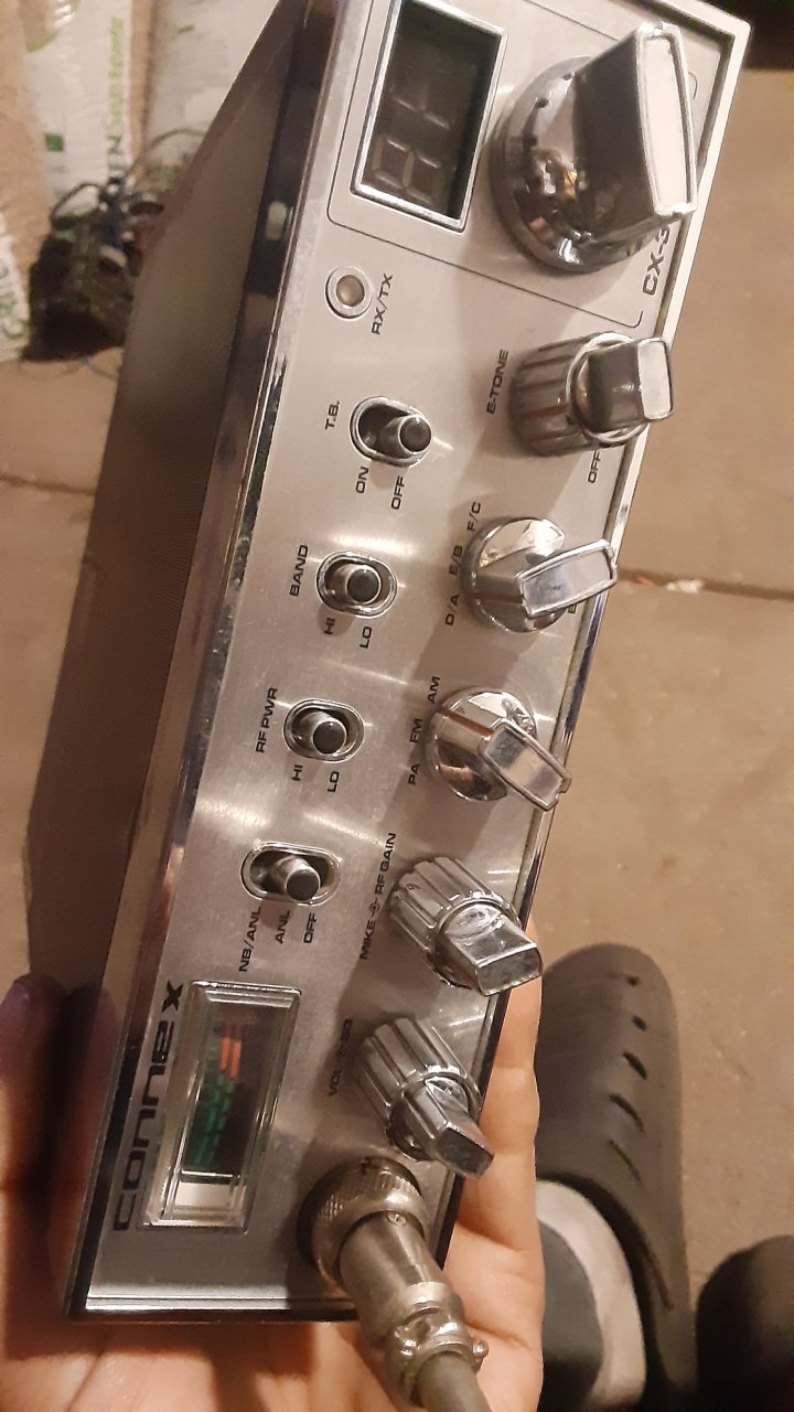

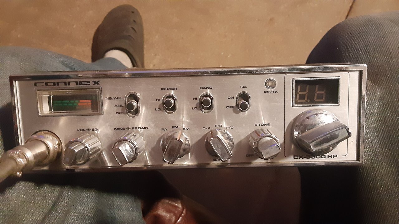

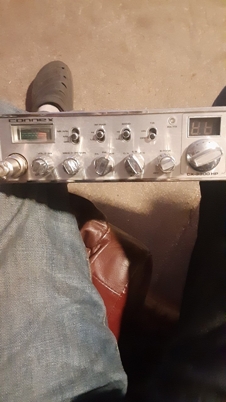

    I have a connection CX-3300 HP WHAT SHOULD I HAVE IT ON TO BE ON A REGULAR CB CHANNELS . THE 1 SWITCHE is PA FM AM AND THE OTHER SWICH US D/A E/B AND F/C . THEN ABOVE THAT IS A BAND SWITCH HI LO 20230825_033825.jpg 20230825_033839.jpg 20230825_033813.jpg 20230825_033825.jpg 20230825_033839.jpg 20230825_033813.jpg 20230825_033825.jpg 20230825_033839.jpg 20230825_033813.jpg 20230825_033825.jpg 20230825_033839.jpg 20230825_033813.jpg

    I don't own a connex radio, but according to the previous posters you have it set correctly for the CB band.
