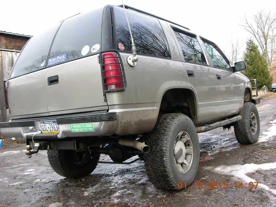

    I highly recommend a ball mount like the one on this 99 Tahoe it's much stronger[​IMG]
    handlebar and Straight Stacks Thank this.
