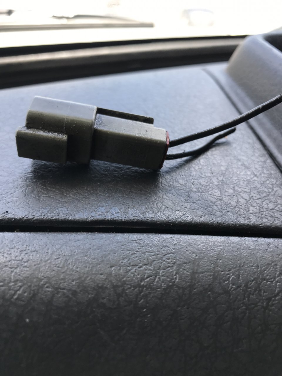

    Issue solved for the code that my truck was throwing it to me. SA 0 SPN 97 FMI 3.
    Enden up being a broken wire from the bottom of the fuel separator housing. Ordered new and installing it this weekend. Huge thanks to @Newto Trucking and i will post a pic and part number of the wif sensor:
    IPD-USA
    DT04-2P
