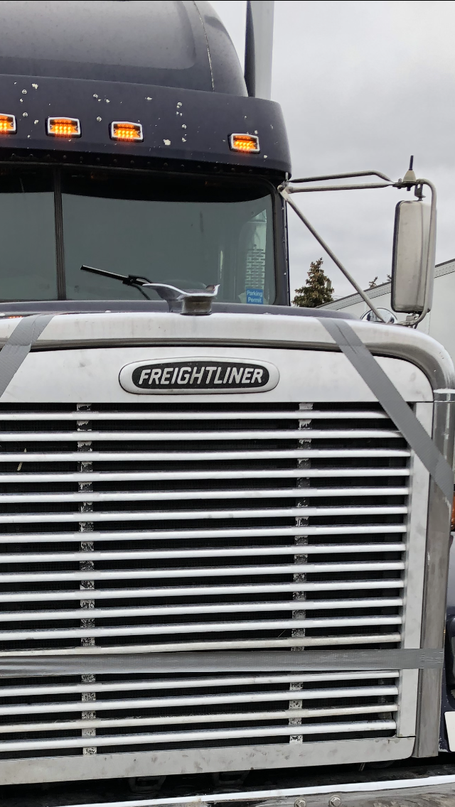

    39975090-32EE-4962-A532-9EF5AFB3967B.png Best way I’ve found, 4 - 7/16 nuts in each inside corner. Rubber mounts/ bolts might break. If so you’ll need to replace mounts,on grill before re installing.

    I was cheap on the duct tape :)
