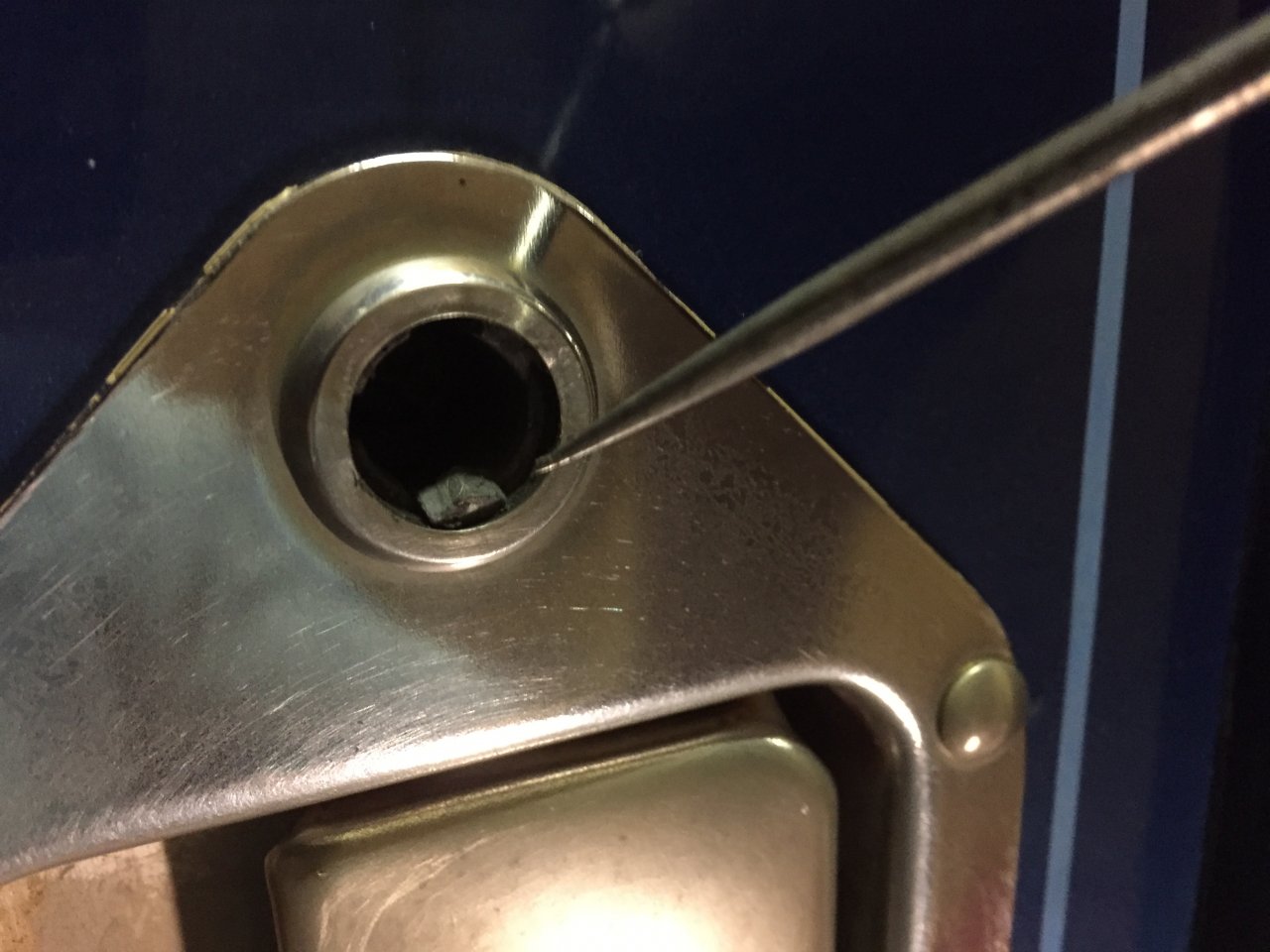

    Is this the same procedure for the ignition?
    I purchase a new lock set for a 1999 T 800, the door locks came complete, just had to take the clip off the back, the ignition is like the ones in your picture.

    No it's not the same! The ignition, you have to use a pin or extremely small screwdriver to push in the C clip on the ignition barrel, and slide the barrel out. Then simply push the new one in.

    I don't see any area on the ignition switch to push a pin in, mine is completely sealed.

    Thanks for the reply, i had to remove the switch to see the hole, worked great, Thank You!

    I should have mentioned you have to take the switch out, but yeah, easy job.

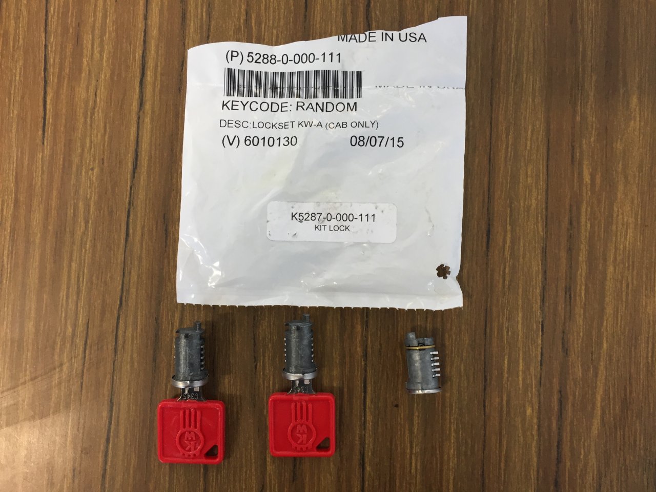

    I got old tumbler out but the new one keeps falling out. What holds it in

    I got two with mine and five locks

    Got me. Not well said by me. Two identical keys fit all five locks.
