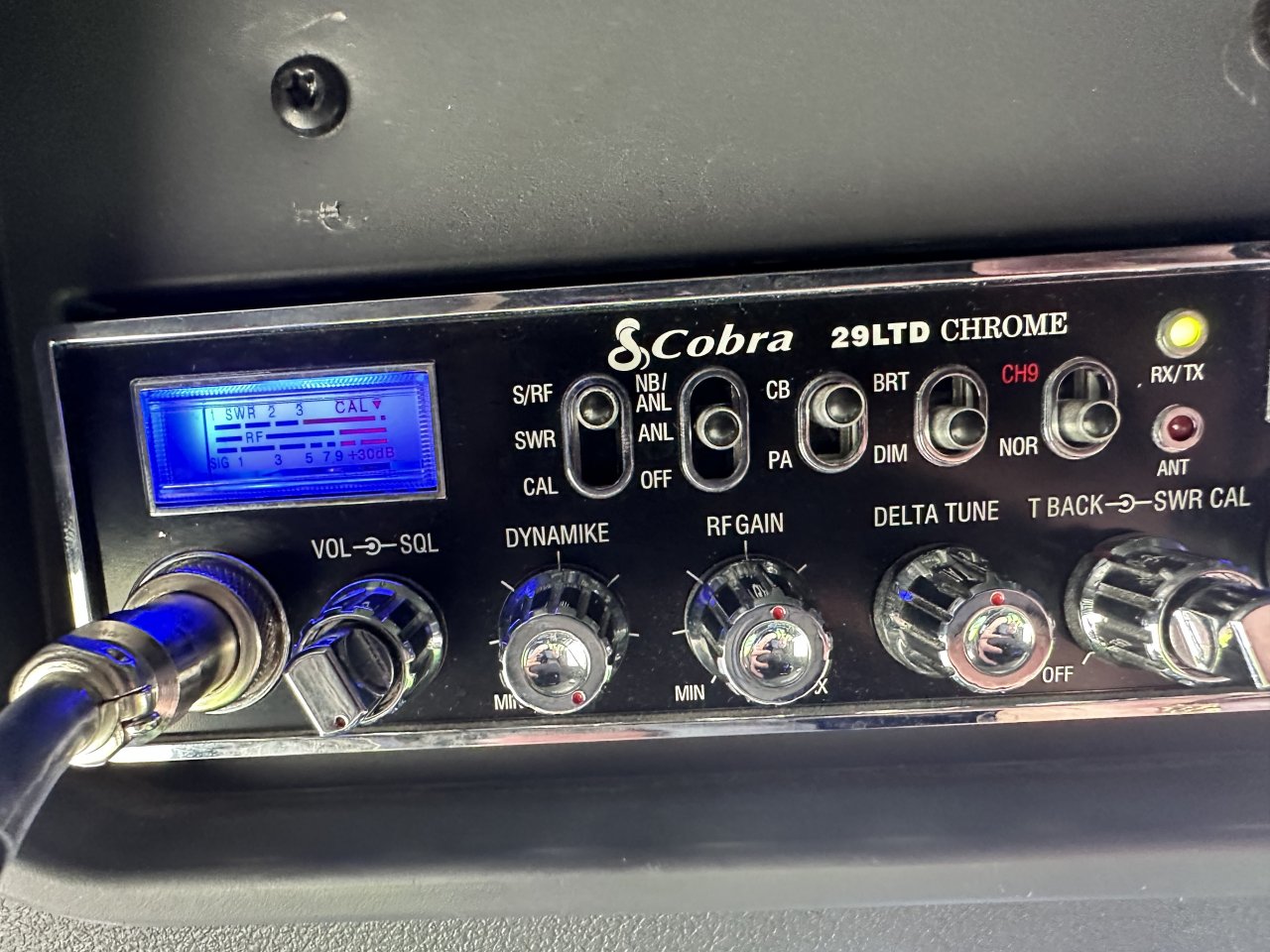

    OK, so how do I check what the background noise is? by looking at the meter on my radio?

    This is what I got it at now rf is like half and squelch is practically almost all the way down

    Yes, if you turn RF gain all the way up, wherever the needle on the signal strength meter is when no one is talking is your background noise level. The signal strength is measured on a scale from 1-9. The background noise level can vary quite a bit depending on location, time of day, and other factors.

    That's probably just fine. When the RF gain is turned down to reduce the noise, you won't need to have the squelch as high to cut out the static. If very weak signals still break through and you don't want to hear them, just turn up the squelch a bit more until you don't hear them.
