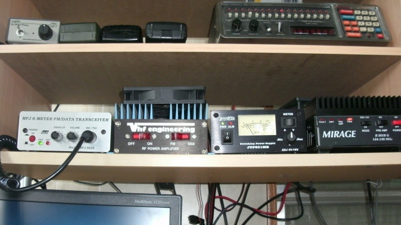

    Ok .....
    1st .... There is no such thing as a CB linear ONLY lnears being used illegaly on CB. AS for the RFX-75 I'm not a fan of butchering up radios ... SO I would get one of the ILLEGAL FOR USE ON CLASS D CB boxes ....... and have fun ........
    BTW there are linears like these that are sold and are legal and will not work on CB so make shure you get a CB one ......
