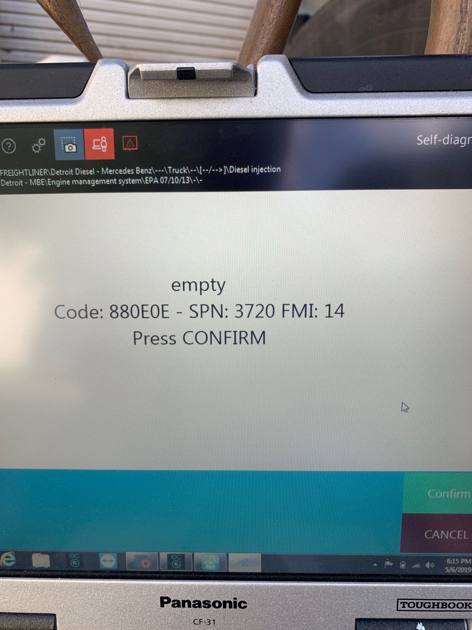

    Hey
    I am sorry
    But I have it this issue on my 2017 Cascadia
    Light come on
    Then I stop. I try do Regen. If not late me.
    I drove 40-50 ml.
    Check Engine light on with yellow light is flashing but I have all 4 green light.
    I stop. I try do Regen again. It not late me.
    Then I find garbage TA. Wait for 4 hours.
    Search in google
    Every one Who has this problems
    Clean the DEF trunk. Drain. Get off.
    Cleaned. Dry it. Put back. Change the DEF filter. Change Doser.
    I ask if you have it filter. Them say it’s no.
    Any way did it diagnostics. And told me. I already new. No help! At all! It was Richmont VA off 95. I went to store. Bought everything. I did it. But it’s still have same issue. It’s driveble but don’t go over 55.
    What next I can do it?
    I am sorry

    So what codes can you pull off the dash? Should the a SPN ### FMI (or FAIL) ## post those and maybe we can help. From what you’ve posted all I can tell you is you have and after-treatment issue that’s been ignored.
    Also, with those light flashing that way, don’t fill diesel or DEF, you’ve got a good chance of initiating the Government Code that locks you to 5 MPH...

    I don’t have it code yet
    Issue none
    Active code NONE
    Diagnostic
    Issue NONE
    Just come back a home
    I will plug in to my computer and I will post a picture tomorrow

    880E0E - SPN: 33720 FMI: 14

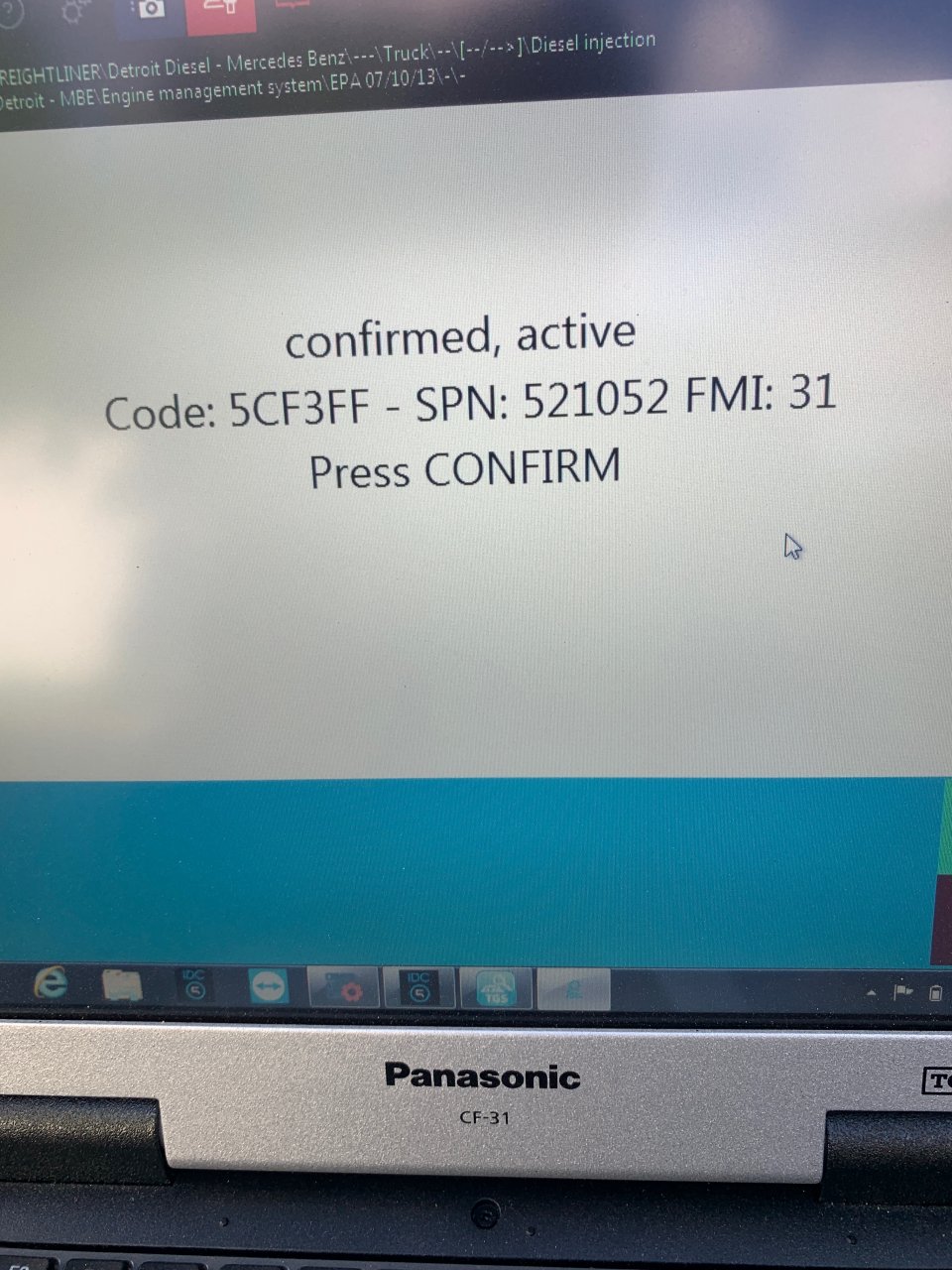

    5CF3FF - SPN: 521052 FMI:31
    59F3FF - SPN: 521049 FMI: 31

    I force Regen with computer.
    And I can’t start with key anymore.
    This code I have it now
