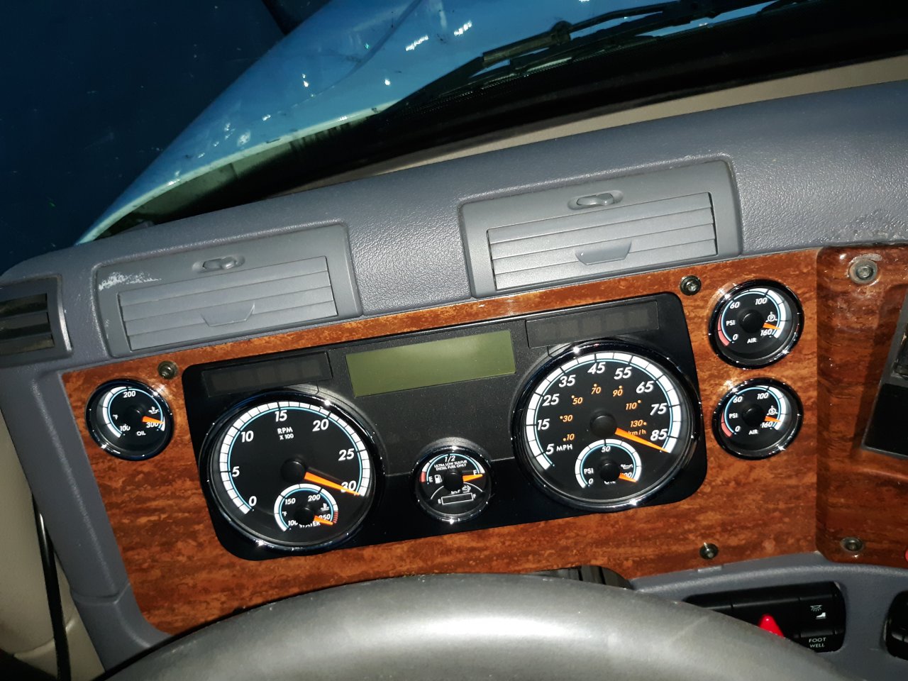

    I've got a 2016 freightliner cascadia, the horn wouldn't stop going off randomly so I pulled the fuse, now my dash isn't lighting up. The accelerator isn't working either and gauges arent responding. How do I fix this?

    When I do the ###### horn goes off again. So I have it out right now. Do you think that'll fix the dash? What could be the issue with the horn?

    SAM cab module

    That’s what was wrong when my horn started blowing , lights flashing, plus wipers going full blast.. That’s when I found out most cascadias have a improperly installed windshield and water leaks into the computers and fuse area. 1 tow and 7,000 dollars later I was fixed

    Makes sense, my windshield has been leaking

    Usual culprit is "clock spring" mounted under steering wheel first. Unfortunately must be done with laptop.

    Find the horn, apply a side cutters to the ground wire, put the fuse back in and keep on driving, that's how I'd fix it.

    I had similar situation. After rain horn started with windshield washer . I pulled connector from horn. Washer pump worked long and died. I put plastic piece on sam cab module and rerouted wires that come from id lights of roof. I made them to go lower of module then rise up. plus I cut some insulation and water now go strait down. no way to stop the leak but its possible to make water flow changes )))

    most new freightliners have a cover over the fuse block to aid it the water run off.
