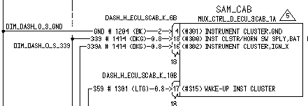

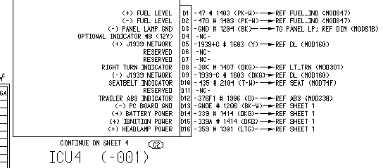

    Yeah your SAMCAB controls the PWR and IGN to the cluster (light bar). Make sure to check that. Also verify J1939 is getting to the connector as well for the CAN. If your gauges aren't sweeping with key on, makes me think of IGN.
    Match up the CIRC to each one individually.

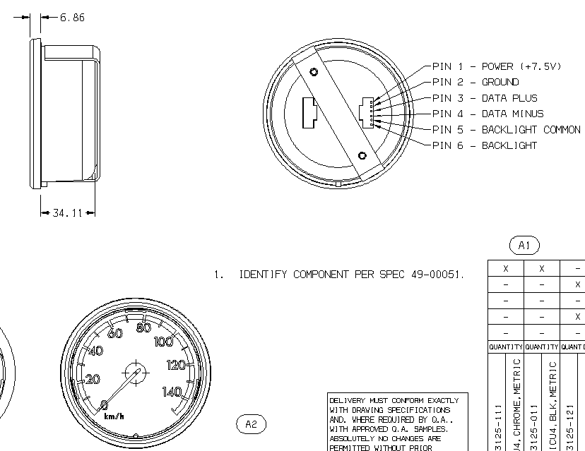

    You could also have one of the daisy chain gauges messing up the data. The speedo head acts as the main gauge that controls everything connected into it and down the line. Those tiny pins can get bent/corroded/bad connection. Try only connecting the speedo head into the light bar and start from there.
