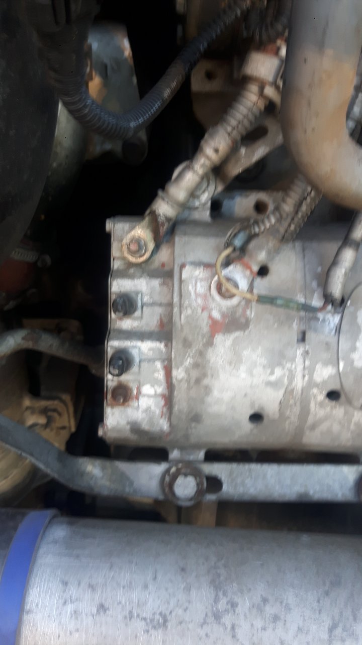

    My 2008 with Series 60 had nasty electrical issues and I'm trying to track them all down.
    I noticed that the previous owner disconnected this little wire to the last post on the alternator. See picture.

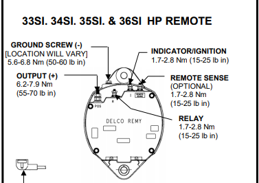

    What does this wire do and where does it go? I'm guessing that it is the sense wire but I'm not getting any codes. I have put it back on and the alternator puts out 14.82 volts with or without this wire attached.

    That's my understanding it's the sense wire. So the it can tell how full or low the batteries are and adjust power output as needed. Some truck have them and some don't

    Here is a little info on the sensor wire. You can Google it also. It basically helps the alternator know how much voltages the batteries are getting after all the cables so It can put out more or less power to the batteries as needed.
    What are Remote Sense Alternators | Delco Remy

    A bit of mis-information in this thread.
    From the looks of it, you have a DR 36SI and nothing is hooked up.
    Yout want your sense connected in order to NOT over charge the batteries. Nominal voltage should be no higher than 14.2 volts. Makes sense that you had to replace all the batteries because you were running at 14.82 volts. Contrary to popular belief, alternators are not made to charge completely dead batteries. They're certainly able to do it in some cases, but it puts unnecessary strain on the system and can eventually ruin your diode trio. It's hard on the system.
    You say you have a wiring problem and you posted in the Freightliner section. I can look up information for you with the last 6 of your vin and possibly help with wiring that you are inquiring about.
