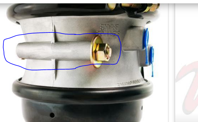

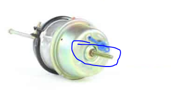

    You can uncage the emergency/park brake. There is/should be a long threaded bolt on the outside of the chamber with a washer and nut. If not get or borrow some. The end that is not threaded has 2 fixed pins. This goes into the brake chamber end after the plastic cap is removed, push it all the way in and turn it until the pins engage and it won't pull out. Use the washer under the nut and run the nut down. This releases the brake and will need to be done on each wheel that has a piggy back chamber. Not on the front brakes. Truck will roll but no brakes to stop.
    RockinChair and Oa707 Thank this.
