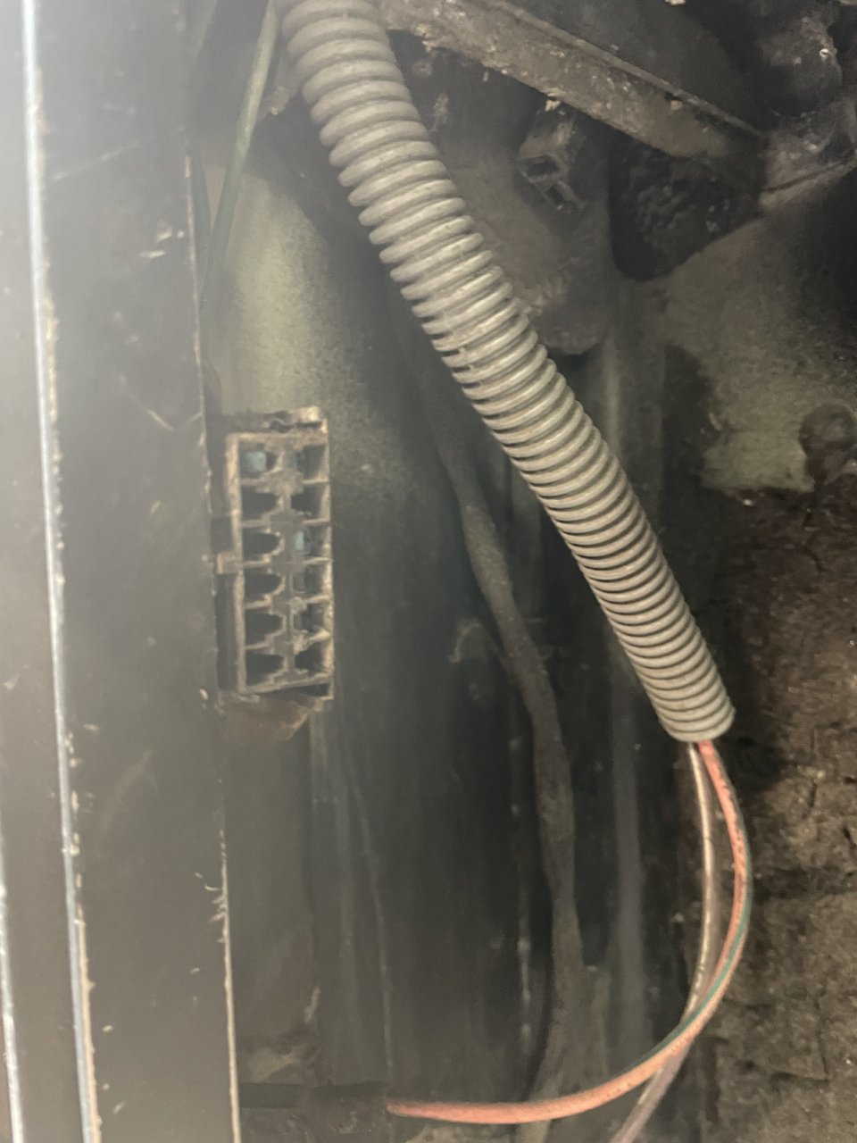

    IMG_4823.jpeg Got a hold of a guy who’s gonna plug it up this evening or tomorrow. My plug is evidently the old style DDEC2. The newer one is round. Guy said it could be as simple as a fuel temp, boost, ………. sensor.

    Exactly. Abnormal sensor data or nonworking sensors will be pretty obvious once he looks st it. I'd hate to see you pay a bunch of money for nothing or lose the ECM altogether. Let us know what it was when you figure it out.
