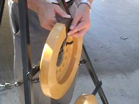

    with your motor in the million mile club. have you had your "crankshaft dampner" or harmonic balancer inspected or replaced.
    it has a nasty way of throwing weight around.
    as well as the bull gear. both should be checked.
