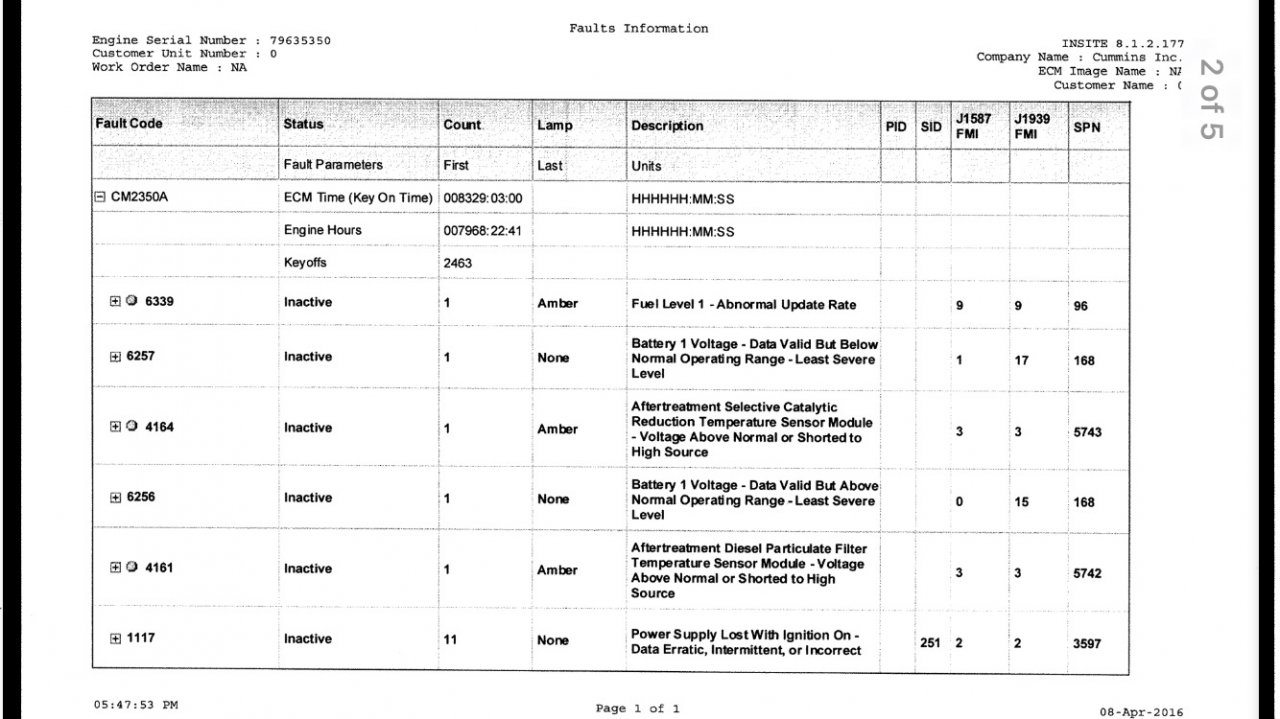

    I am checking out a truck (2014 with Cummins ISX 450), serial number of the engine is 79635350, which according to my research is a "good" fact. Truck has +- 380,000 miles, it is clean on Rig Dig and I checked with manufacture and is also up to date with updates.
    I asked for an ECM print out (Attachment). If anyone has some free time and could give me an opinion would be of great help. Is there any other report from the ECM that I could ask?

    Ask them to print out
    engine abuse history
    Regeneration history
    Duty cycle
    Post it here I 'll comment
    Looks like ECM was reflashed for sale

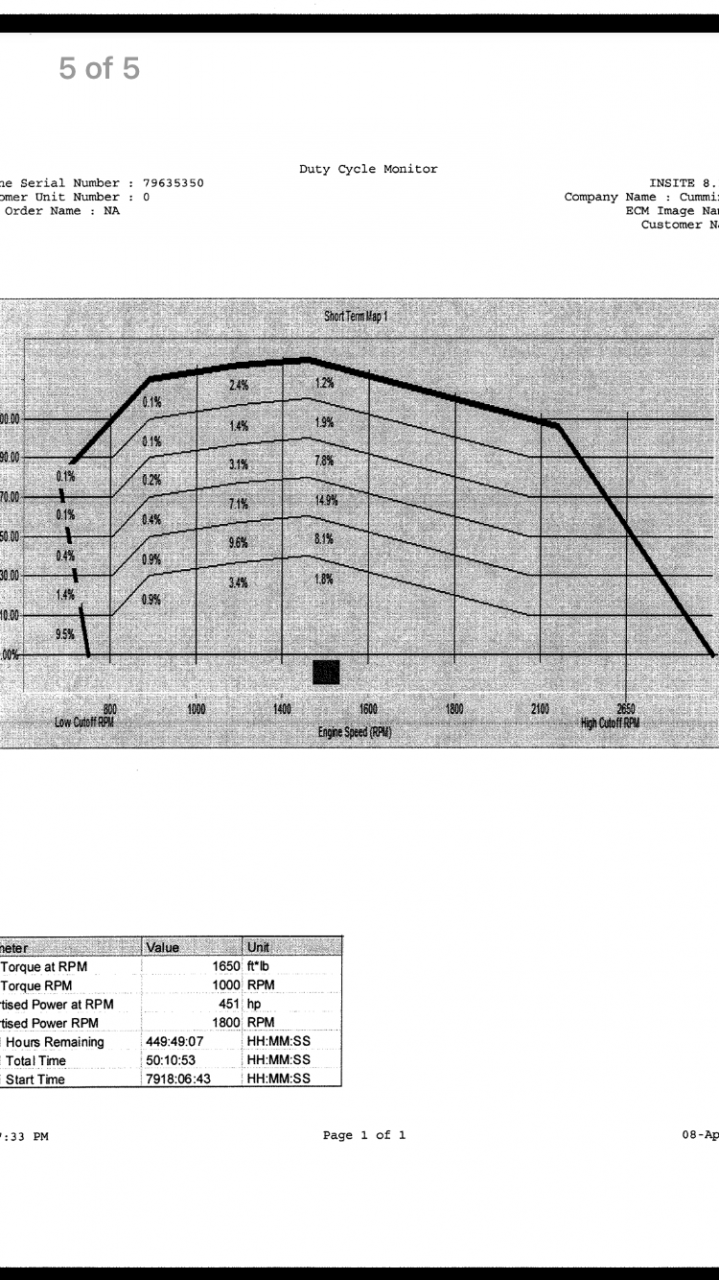

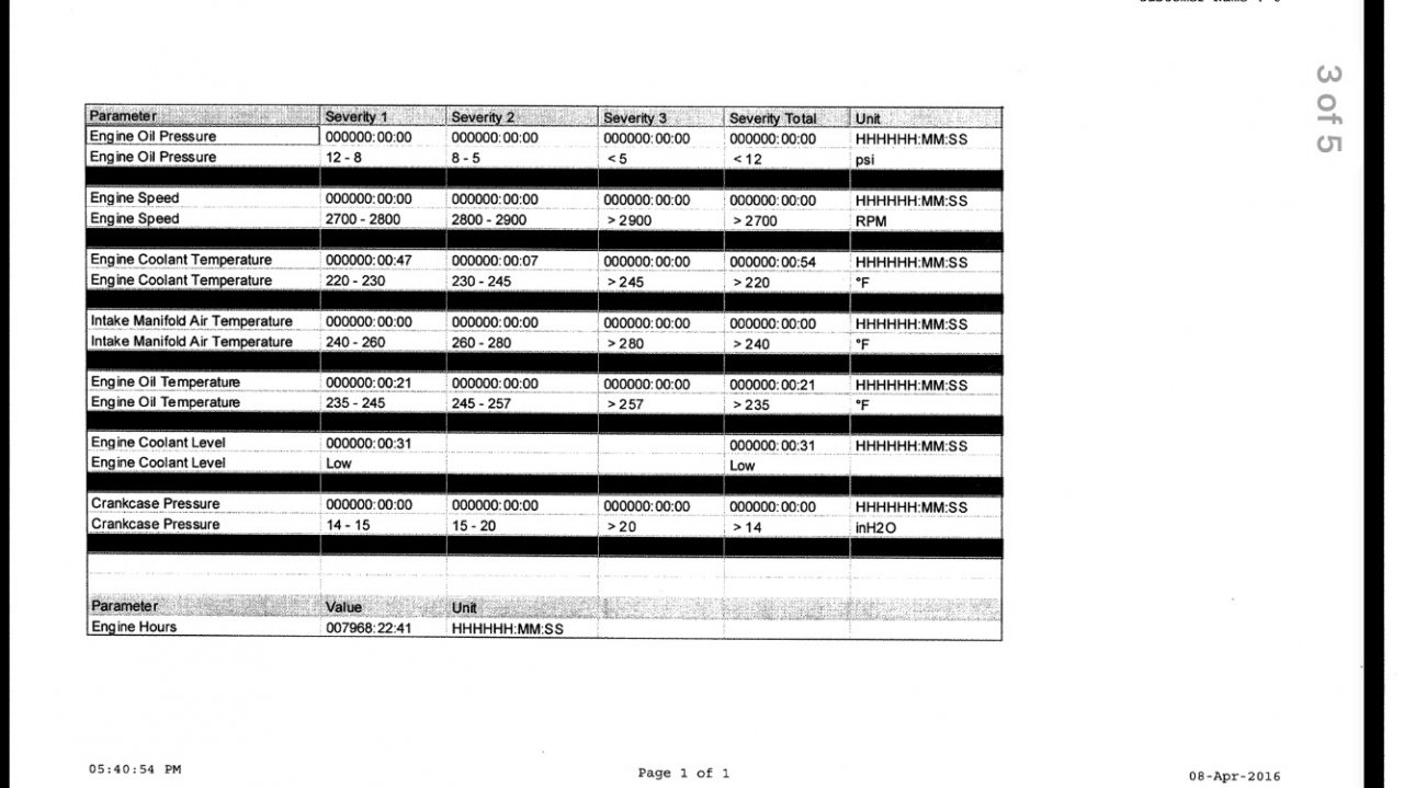

    I believe this report is more complete. Sorry for the delay the dealer has just sent them in.
