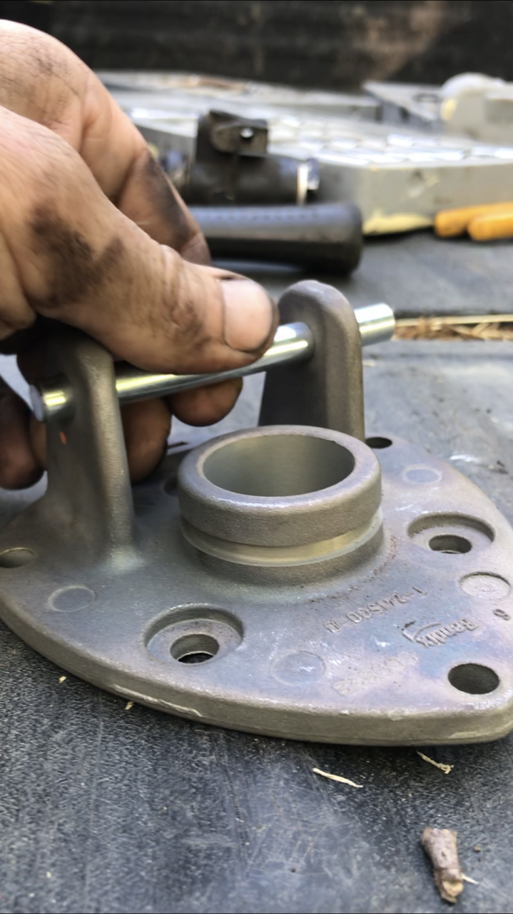

    First place to go is inspect the brake pedal pin for being frozen. After that it is likely the plunger in hanging is the top of the treddle valve or foot valve. The plunger and the boot are available separately and should be in stock at every pete dealer in the country. Sometimes all it takes is disassembly and a thorough cleaning and lube of all parts. On older trucks, I've had to replace everything including the valve and pedal, mount.

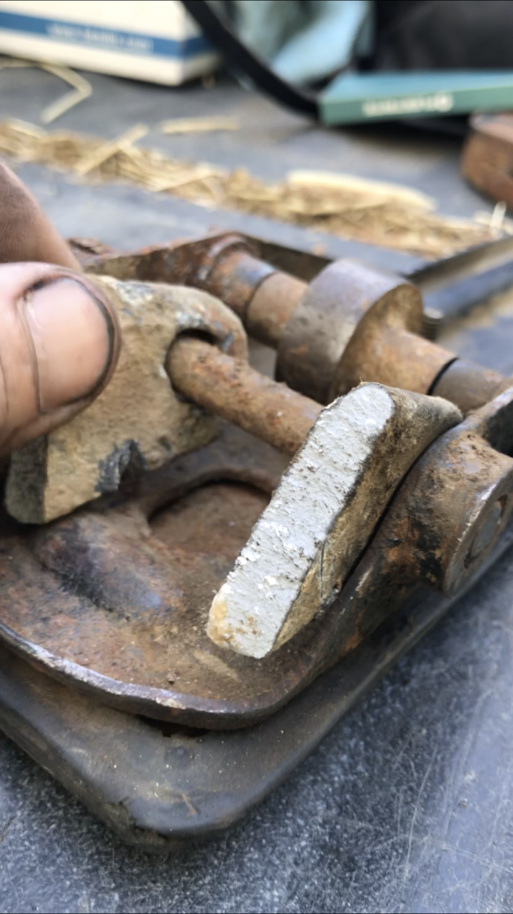

    Dam I went through this as well. I just did this procedure on my 379. The whole brake pedal mount was in very bad shape. The holes were elongated and the pin was completely frozen in the brake pedal itself. 2 bolts that go through the mount and into the valve snapped off. I was able to drill the balance and retap new holes through the bolt holes while still installed on truck. I put anti sieze on the new plunger and everything is smooth and feels like a whole new brake pedal.
