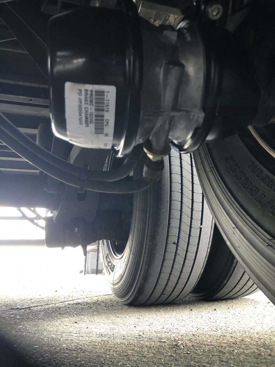

    First time in 7 years driving dealing with a bad brake chamber on 2022 GD dry van with disk brakes. Also going to be the first time rescheduling a delivery due to a breakdown. Delivery isn’t critical ( junk from a business closing) but my ego is taking a hit.
    Trailer has been in service for 2.5 years and brake pads still look new since I go easy on them.
    I’m really just curious if 2.5 years is normal service life? The bad chamber is losing 5+ psi per minute so I put myself oos. Stuck at the Petro in Brazil, IN until tomorrow. They don’t have what I need in stock and it’s Sunday so I’m sol until tomorrow.
    The chamber that’s leaking bad has a yellow/green dust all over it. The chamber on the opposite side of axle same color dust but only a small amount. The rear axle chambers have just a small amount of rust colored stain which I believe to be normal.
    What would you do in my case, replace just the one chamber or all at once. Definitely I’m going to keep a spare in the truck from now on.

    @wichris @BoxCarKidd
    Well all fixed..sorta.lol, I got crap luck with techs.
    I got the leaking chamber replaced and another replaced. Kept the one that wasn’t leaking as a spare.
    Feeling like I took it in the caboose at payment time…parts cost, markup and delivery fee seems ridiculous. Labor not bad $60.
    total bill $1,003.61
    Just kind of stewing over the price I decided to go under the trailer to see what I paid for and confirm there’s no other leaks
    Thanks to both your replies I know have a better understanding of what it takes to replace one myself. I’m quite positive I could do a better job than I received..even if I was drunk.
    Drain holes aren’t at the bottom..more like sitting at 7:30 and one completely covered by a sticker that isn’t going to just fall off anytime soon. Plugs on the top weren’t put on and for the finale…A cage bolt left on. I’m just guessing that would probably give the abs some issues.
    Couple pictures for laughs.
    Update: so I just got informed that the bolt I’m seeing is actually in its holder.

    The disc brake chambers are not as cheap as the typical aftermarket drum chamber.
    I would be worried about the clocking of the chambers. Those brake hoses are hanging low may be knocked by road debris and the cheap hose ends will snap off. Note how the other axle are clocked higher.

    I agree and noticed the clocking wasn’t correct. Had he adjusted it so the drain hole was on the bottom everything would have been great.
    I’m going to have it adjusted better but I’m done with this place, too inept for me.
