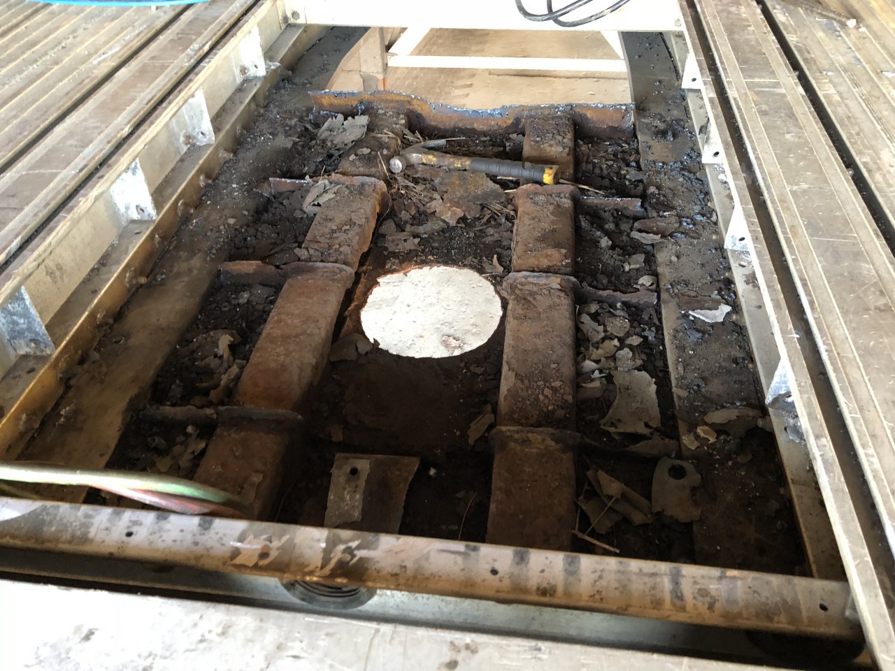

    ive got a chance to buy a 05Ravens all aluminum 48/102. The guy says the 5th wheel plat needs to be replaced soon. Not sure how bad it is, if it will last 6 months or a year. I can buy the trailer under book, it has a cones toga kit. Is this a deal breaker, cause of the plate, where I assume it didn't get greased enough? Thanks in advance for you wisdom. Cones togas are hard to find in good shape, and I need to get to work!

    @Tug Toy has pictures off replacing that plate .
    Most likely it has nothing to do with the way it was greased.
    But the supports above have bend/cracked or corroded.
    Don't buy it untill you fully grasp what is involved in replacing that plate.

    I do wonder just how expensive it is to have it replaced?

    I think he said the final bill was $4800.!

    Yea, did that, it’s going to be around 5-7k. I’m out on that trailer

    Just had mine done for $5000 (well $4800 plus the tow and the service call) 36ECE509-79D7-4979-8C03-2A6F78679BA0.jpeg

    Wow that’s crazy,
