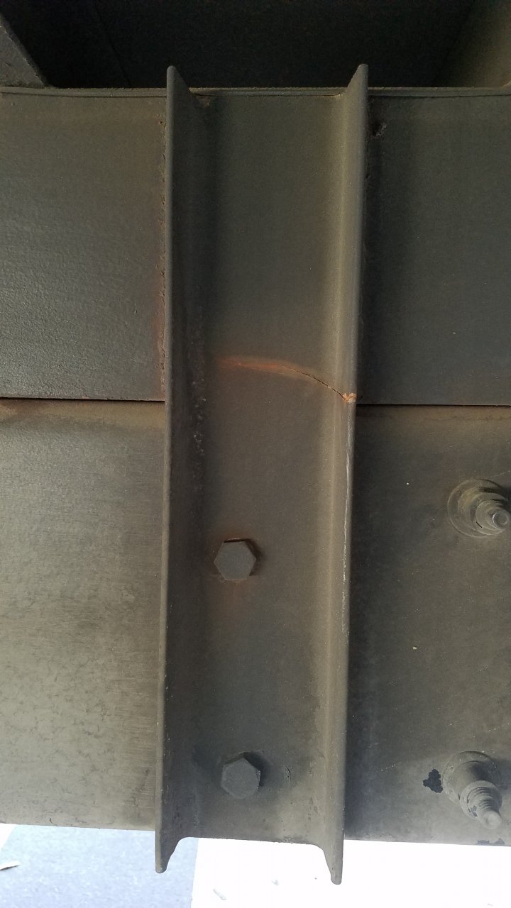

    Hello and let me first take this opportunity to apologize if I posted this thread in the wrong place. I have a medium-duty flatbed with a crack in one of the mounting brackets (see below), which obviously needs to be repaired immediately. FMCSA says any welded frame (or body) repair must be in accordance with the manufacturer's recommendations. Maybe it's just me, but this description seems kinda vague. My boss wants to take the truck to an experienced welder to repair the crack and call it a day, but I'm thinking this bracket must be completely replaced. My question is, if I have this crack weld repaired, would it be considered compliant in the eyes of DOT or any law enforcement that may decide to inspect my vehicle? And even if it does comply, would it draw any unnecessary attention, especially to that area? Any help is greatly appreciated. 20190711_101244.jpg 20190711_101244.jpg

    I was a mechanic in a former life, I have done these jobs. I say Cut the 2 weld and replace it with a new piece of channel. A bracket like the weld the crack and in time it will crack right beside the weld. Cosmetically it will keep the dot from knit picking. And yes I went and got certified for welding at our shop to do critical welds.

    You could groove it out and weld it in. I would consider it to be a acceptable repair as long as the box is secured and not loose. Long term the channel will likely re-crack on the edge of the weld.
    A better repair would be to replace the piece of channel with new and would likely not cost that much more to an experienced fabricator.

    Cost more to weld. Replace with a piece of C channel. And call it a day.

    That's just a guide channel...... New piece and revolt.

    You can replace that cheaper than you can have a weld shop repair it... Cost of channel will be like $10 or less... Cost to have weld shop repair will be at least $60... If not $120
