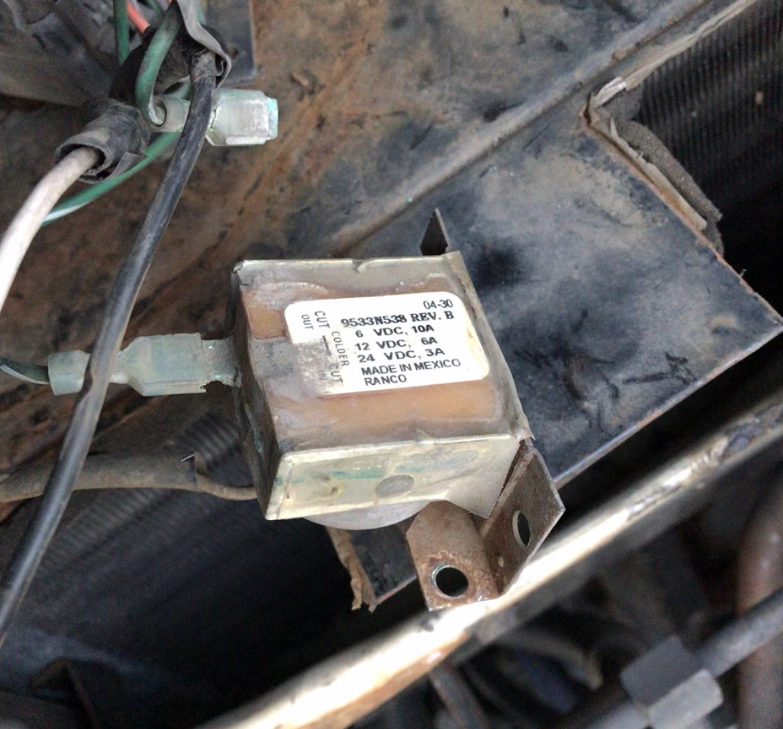

    Are you talking about this tiny part? As you can see one connector is broken off. Could that be reason for blower motor not working? I thought this switch is just for compressor. I am not worried about a/c now though, just need heat.

    No, not sure what that is. The relay i spoke of is in your breaker panel. Took a while for me to find it because it is in the opposite corner of the panel from the rest of the heat/ a/c related stuff so i never found it when i looked for hot ones. It’s the one that engages the A/C clutch when you turn Defrost on. That module you show i have no idea about, but it’s a safe bet that an electrical device with a wire off it will lead to one or more things not working.

    Attached the diagram. The blower motor gets power from fuse H11 and is constant with key on. The blower motor is switched on the ground side. The resistor block allows for the low and medium speeds. Hi speed does not use resistor block. Need to check operation of switch. Plugs are known to melt. The broken part you pictured is the freeze protection switch and would be shown in diagram directly above the blower motor. It opens circuit if evaporator gets around 28 degrees to prevent freeze up and only effects A/C compressor operation. I have replaced quite a few blower motors that didn't work in truck, but would bench test "okay". Motors get a bad spot on shaft @ brushes. If you spin it and it takes off again in chassis you have a bad motor. Need any other help let us know.
