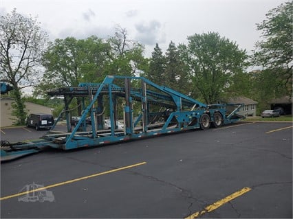

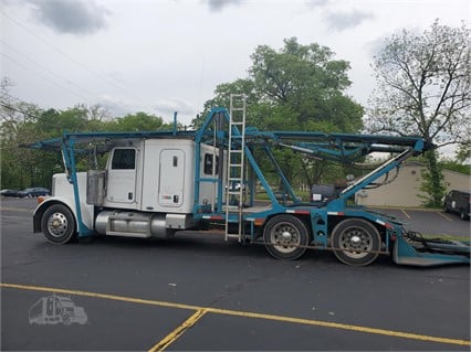

    Boydstun makes a good unit. The older ones get weak in the front of the trailer and then the hitch starts angling up. The cross pieces under the hitch rust out and must be replaced. Same thing with the rear of the trailer, although the newer ones have a support horizontal under the axles that help support the rear section. If there are cracks in the side rails above the trailer tires, it needs work. Also the Boydstun is difficult to stack large vehicles as the front top middle deck will not go low enough. I changed the cylinders to the 3 stage ones and then the deck goes lower.
  8. mnmover
    mnmover Road Train Member
    1,237
    1,104
    Apr 5, 2009
    Lichfield MN
    I also moved the upright post behind the first cylinder ahead next to the cylinder so I could open a door and get out when loading and unloading.
