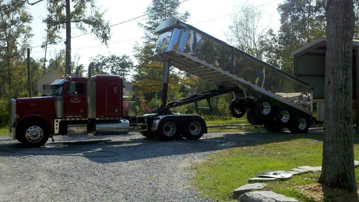

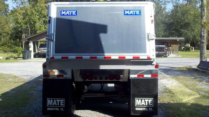

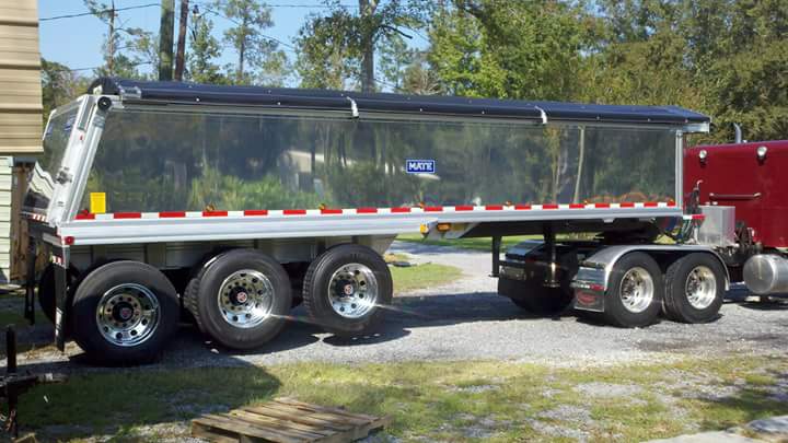

    Have you looked into MATE end dumps? My boss just purchased is 5th trailer from MATE and has only purchased from them because of the duriblity of the trailers. The trailer my boss ordered is a 30ft frameless 54in sides and smooth side. The empty weight is about 13,000 lbs but thats with a Shurlock tarp, tri-axle, and heavy duty draft arms.

    That's a nice looking trailer!
    I wonder what the empty weight would be on this trailer as a 37' tandem.
