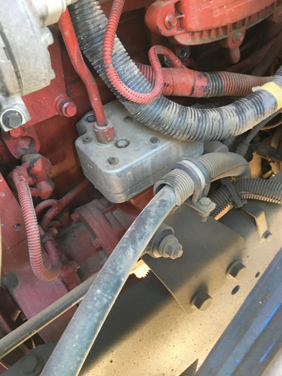

    Having a problem on an International 2010 8600 with an Cummins ISM. The other day I noticed that the air tailgate latch in the truck was wet when I flipped it and water was present at the valve in the truck. Obviously I figured out there was water in the system. I went to drain the air tanks and one of the three eptcocks released a bunch of water. I have noticed lately that the air dryer hasn't been purging air like it usually does. I ended up changing the cartridge on the air dryer and nothing has changed. Last year I changed both the cartridge and purge valve on it. Seems like when I'm on the road hammering on the throttle the air dryer seems to spit off air as it should. At idle and low RPM, it doesn't seem to be spitting out air. It seems like every ten seconds or so I can hear the air under the hood spooling up under the hood but the air dryer doesn't spit off. I've been doing some research and it seems to point to an air dryer internal issue or a governor issue. I've changed brakes and have done some major maintenance on my trucks in the past, but I'm lost with this air dryer issue as I haven't messed with them much. I'm not even sure where the governor is or how to check it. I believe it's a Holset compressor. I purchased a new air dryer on ebay for $150 as I figure its worth it as I just spent $100 on the element from the local parts store because I needed it quick. I don't want to switch out the air dryer unless it's bad. Would rather figure out what the problem is. A picture of it is included. Any help would be greatly appreciated as I'm sure I can fix it as long as I know what to look for.

    Heavy D, is the unloader valve in the head of the compressor on this truck? I'm starting to think that's where the problem is after doing some reading. When the dryer was purging, it was going off every 15 seconds or so which seems to be way too often. I'm going to pull the fender off today so I can get close to everything and check for leaks.
