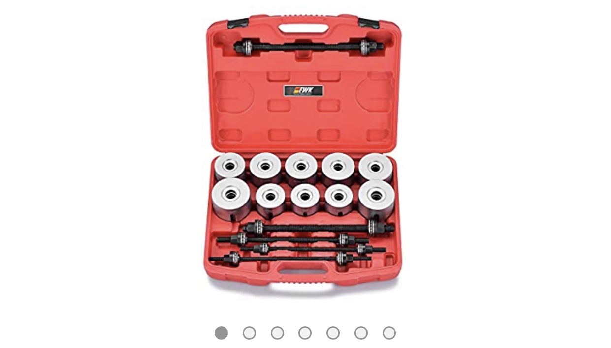

    I’m looking particularly for basic tools. Some people burn the bushings and then hammer it out. Has anyone used some kind of press to remove bushings? Amazon has various types. I’m trying to figure out which one to buy that will work on a 2014 Freightliner Cascadia.

    Theirs are very nice and efficient, but the air press version is going for about $2000. I’m okay with a manual press.
