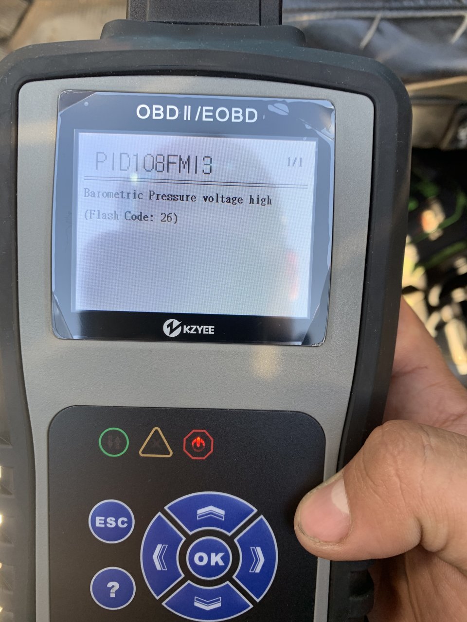

    I’m having a code come up on my truck it’s barometric pressure voltage high flash code 26 any body have any idea what it could be maybe a bad sensor and where exactly is the sensor located it’s on a cat c-13 2005 Peterbilt 378 there seems to be two sensors on the intake manifold but I have no idea if either of those two are it.

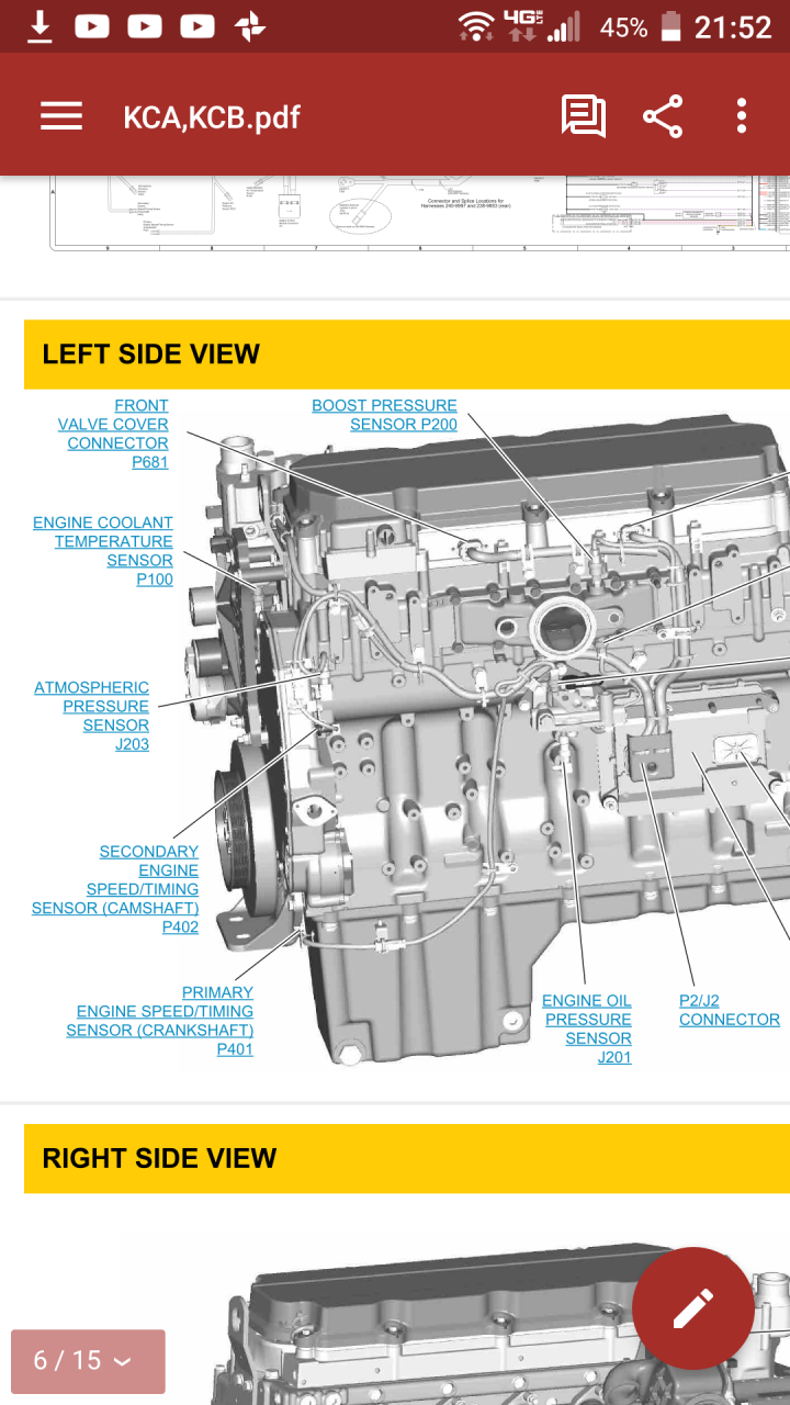

  3. spsauerland
    spsauerland Road Train Member
    4,296
    10,887
    May 31, 2010
    West Harrison, In
    Not on intake, threaded into a tee fitting on front gear cover in front of air compressor. Check over wiring well, probably broken wire or rub in harness.

  4. truckdriver31
    6,989
    8,352
    Sep 18, 2013
    could be a bad baro sensor or a broken wire. should be little 3 wires. the middle wire should be the ecm return volts. should not ohm out more then 5volts

    So the sensor is on the timing cover somewhere?

    Feb 25, 2020
    Would you happen to have a photo you can post?

  8. spsauerland
    4,296
    10,887
    May 31, 2010
    West Harrison, In
  9. Perez700r
    Perez700r Bobtail Member
    34
    8
    Feb 25, 2020
    Thank you it appears the sensor is actually missing there’s nothing threaded into that fitting.
