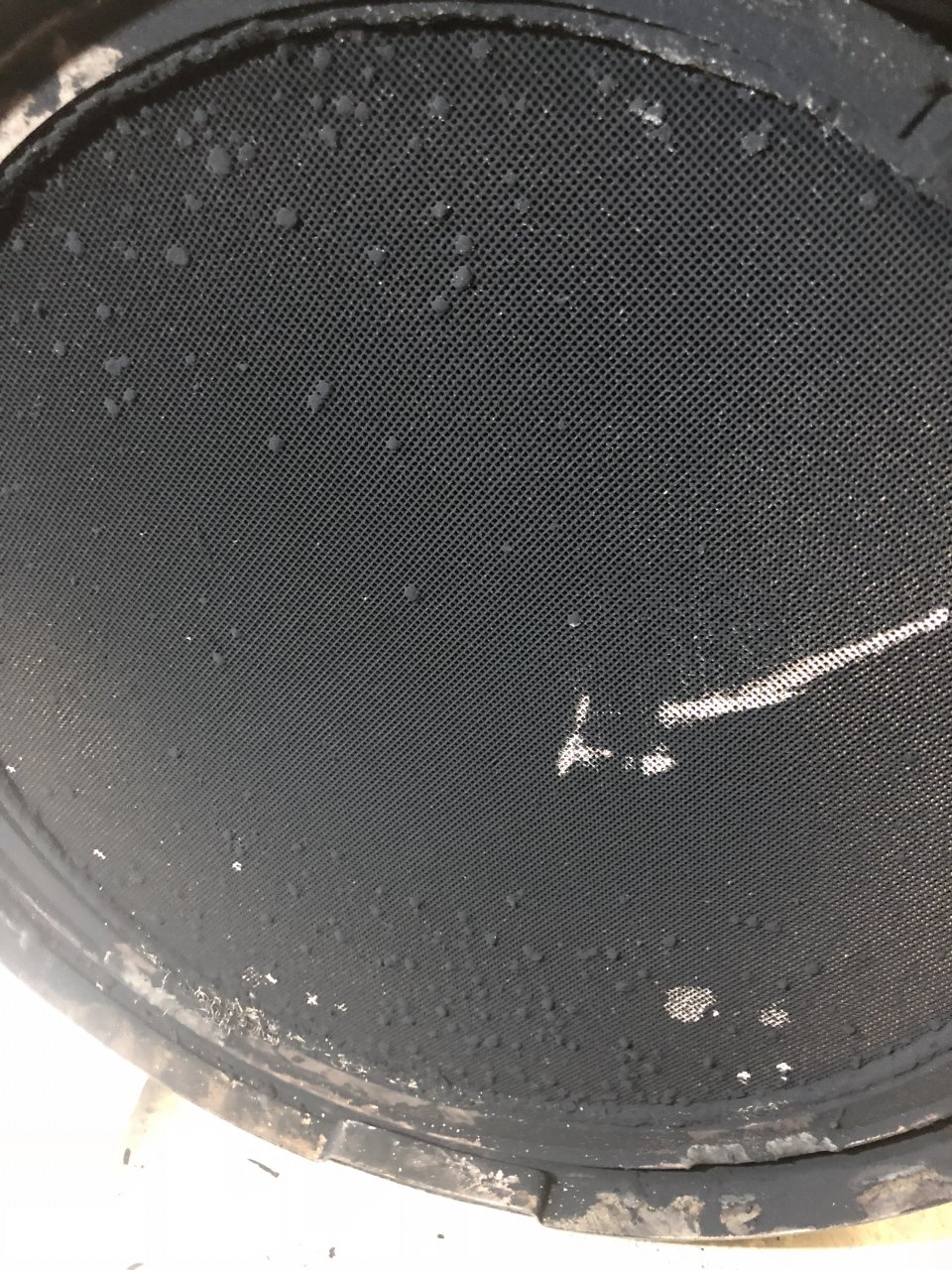

    Ok, so I found the Park Brake switch... Nicely packed in as well... I made a jumper wire and tested to see if it would enable the dash light. Which it did. Now, how do you remove it? It just spins on itself which I assume it is not supposed to do.
    On another note, I removed the DPF to get it cooked. I found an exhaust leak at the top cover and it doesnt look like its been leaking for that long. It also doesnt look anywhere near as bad as I expected.
    Now what would cause high temps on the EGR? Just failing and needing to be replaced?
