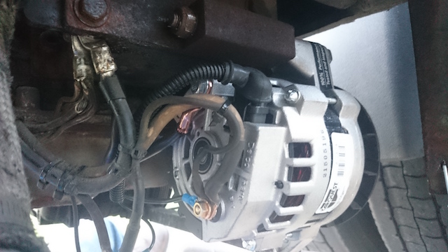

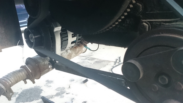

    Bumping this thread with some more current info and a few pics.
    The alternator I settled on came from Advance Auto Parts, their Carquest number 8103-7AN. I had really wanted a new one versus a reman. I didn't discover it was a reman until I went to the store and picked it up. I was out of time, so did not back out and try something else. On the upside, it does have a lifetime warranty so I can get it swapped out with no hassle from now on. I may also get a core refund. The guy at the store said, as long as there's a lump of alternator in the box when I return, I'll get credit.
    I elected to go with the 105A and not the 120A, due to limited time and not wanting to add additional time adapting more stuff to fit the bigger case. I don't run heavy loads on my inverter much at all, so really 65A is good enough. But the 105A does give me a bit more margin. Like a random time when I need to boil water in the microwave for 3-5 minutes for oatmeal or ramen noodles. Even that isn't too bad.
    The regulator pigtail is carried at Advance, BWD part number PT-200.
    I did the fan swap myself. The washer behind the fan was easy. Getting the spacing behind the car pulley was a little tricky. Not many hardware stores carry washers like you need that will fit the 5/8" shaft, and also fit inside the back of the pulley. I made it work with a split washer.
    NAPA has given me another reason to quit shopping there, by changing their belt numbering system and not offering any cross reference to the old system. That, by the way, had been in use since I worked on cars in the '80's and until only a few years ago apparently.
    The guy at Advance was pretty much refusing to do any matching up, so I tried a different method. The belt I took off was a Goodyear Gatorback 6PK1245. That translates to six groove 1245mm outside circumference. Many searches later, 6PK1195 comes up as a valid number for the next smaller size, just under two inches shorter. I find that cross referenced at Summit Racing to a Dayton 5060470. My nearby Advance got that one from a different store in about an hour.
    I had to leave the alternator unattached to the adjuster for it to swing in far enough to get the smaller belt on the pulleys. Once I had the belt seated in it's grooves, I was able to pry the alternator out the tiny bit needed to slip the bolt into the adjuster, that I had already turned all the way in. Then, a few turns out on the adjuster to get proper tension.
    I also replaced my ground wire, mainly because the old one was a hack job and had visual signs of having been hot before. I bought a 24" 4 ga starter cable at Advance and some crimp terminals. I cut the cable down to the 6" length I needed and put a new terminal on the cut end. The cable terminals were 3/8" and the ground bolt on the alternator is an M8-1.5 x 20mm. Not a match, but close enough for a good ground. I did not have time, or I would have found some 5/16" 4 ga ring terminals and done it right.
    Everything started and ran fine. 14.4V indicated on my inverter, so good to go.

    Here's the front view
    Here's the rear view
