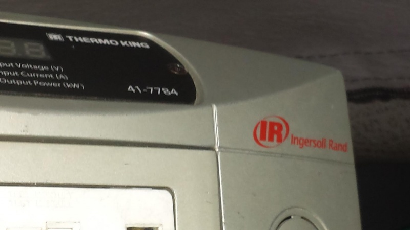

    I bought a used truck with a Thermo King diesel. It doesn't have any manuals or any other paper work with it. It does fire up and seems to be working. It has a control panel on the sleeper wall, a ingersoll rand unit with electric outlet (41-7784) behind the drivers seat and a webasto heater under the bunk. My question is how to maintain it and how often to service. What is the usual type of self maintenance and if needed who do you have service it?

    I was unable to find the user manual for the power inverter ingersoll rand / thermo king 41-7784. The closest I came was a website trying to charge me a 100 bucks for the manual. If anyone knows where I could get I would appreciate it.

    You really don't need the exact manual. They all work pretty much the same. There are three manuals, a user guide (what condo linked), a service manual, and an installer manual. You can find all three online for free. If you go to a TK dealer, they might supply those in electronic form if you ask nice. While you're in there, get a dealer directory. Nice to have on hand when something made by them breaks and you need parts or service on the road.

    TK's inverter is essentially the Xantrex 1800w model.
    Here's the manual. That'll be 1 cup of coffee.......
    http://www.xantrex.com/documents/Po...verters/975-0263-01-01_Rev-C(artwork) (1).pdf

    FWIW, Ingersoll Rand bought out TK from Westinghouse years ago. Some of their products are outsourced and provided by other companies (Like Xantrex) and re branded with the IR namesake on them.
