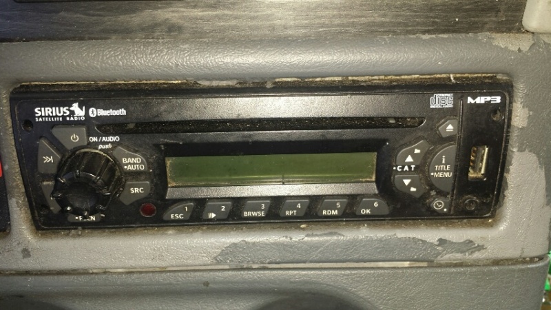

    This radio was in my truck when I got it. I don't see a model number on it. There is a sirius antenna also installed. I want to activate it but all I get is initializing when I change it to satellite. So I'm trying to get the service without taking it out of the dash and I also want to get the manual. All help would be appreciated.

    Had one of these in a company truck years ago. If it has not been used in a while it may say initializing for a while as it updates the radio. one time it did that to me for about 45 minutes before going back to satalite radio. So maybe let it sit like that for a while until it quits saying that. dont change it back to regular radio until its done or it will start over. If it does not quit that after an hour then its not working properly.

    First push the band button and see if the XM open channel line up plays or if the radio ID comes up. Many of those were only satellite ready and require an add on box to get XM. The button push will tell what you have.
    PS. If you need the box it's not worth it. Better to just buy a new receiver that's XM ready.

    On mine,.. when you put it on Satellite, you put it on channel 0 (Zero) and your key or serial number goes across the screen. Thats the number they need to activate it. That number is also on the back of the head unit. Says Sirrus/XM serial #.

    I beleive he cant pull up the radio Id because it continues to say Initializing. I had the same problem years ago and it would not let me scroll throught the channels or anything until it quit doing that. Mine took about 45 minutes as I recall before it would let me scroll through the channels to find #0 so i could see the radio ID. Just my experience anyway.

    the radios are sirius brand, and i could be wrong but i think they're sirius ready. seems to be the only model freightliner installs.
    as for the initialization. probably not going to happen since the radio itself isn't activated. which is probably why it's initializing. it's trying to program itself.
    all our trucks are activated, and it only takes 15 seconds when it happens.
