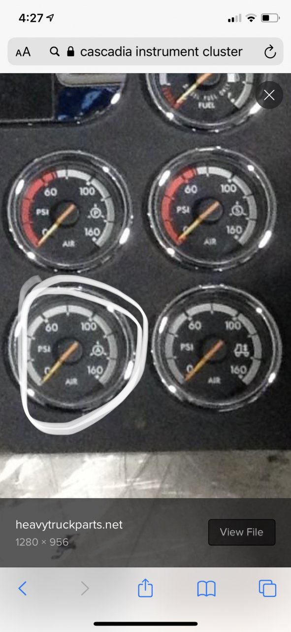

    I would like to know where this is connected to so that I can install it.
    2013 Cascadia DD15, recently upgraded the cluster to include turbo, oil temp gauges and I have one slot open to install this gauge. Can’t find anything on installation.
    any help is appreciated.

    Plumbed into any brake like off the foot valve should work.
