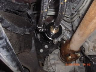

    Here is a picture from my GMC sierra.
