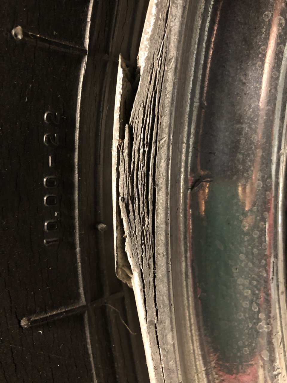

    The elderly ‘22 Alcoa lock ring tube types on my old Diamond T were acid washed and polished years ago by some guy my uncle paid. They were not removed from the truck for years. When I took them off 2 years ago the unwashed acid had eaten the aluminum on the rear inners. No way i’d do that again.

    That's not acid damage, Caustic/lye [base] solutions eat aluminum like that.
    Aluminum brightener usually has hydrofluoric acid sometimes mixed with Nitric acid.

    Any thoughts on were it might of come from? Could the guy have used some homemade witches brew? It has been a mystery to me because there was bluish-green in color spots everywhere streaked in like it had been sprayed on or carried there by moisture. Also another crazy thing is and I can get a pic later if needed is the aluminum bead flange is jacking and peeling in layers between the tire and wheel lip like a piece of corregated cardboard. These wheels are 1951’s but are forged and it’s odd how they seperated in layers like that. It happened very slowly and may still be.
    As far as I know no chemicals could have gotten to it were it was parked except maybe some airbourne fertilizer vapors for a short term.

    Many cleaners are caustic based [sodium hypochlorite/potassium hypochlorite] and will eat aluminum. Who knows what solutions were used over the years.
    Tankers are often in cleaning racks that use caustic as a cleaning solution and are driven thru puddles of dubious concentrations
    Perhaps the guy was a regular at the Streakin Beacon...

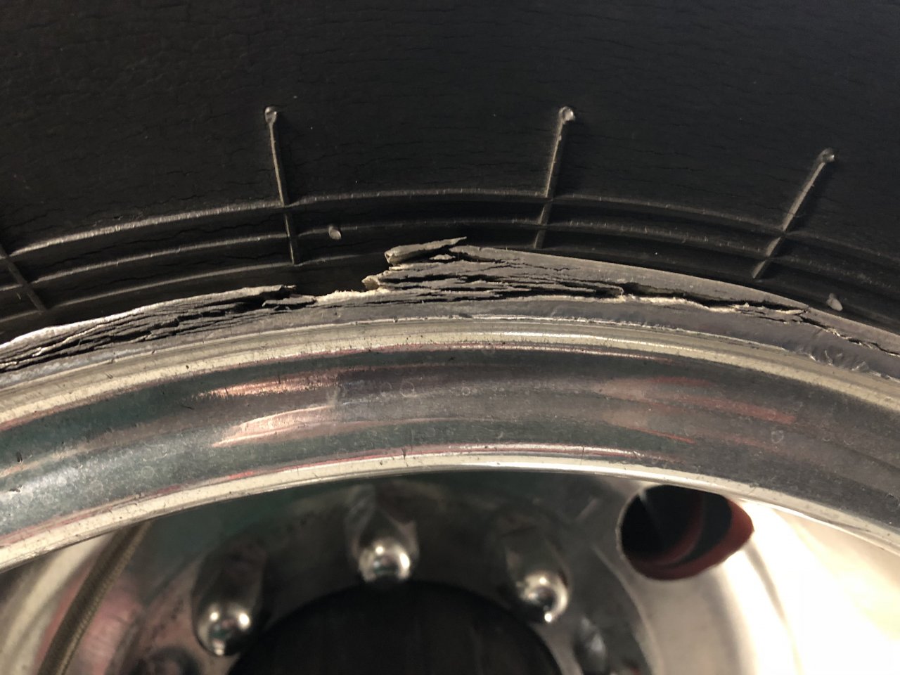

    This is what I was discribing. It seems that only one out of 6 is doing it like this in 3 different spots. On the bottom pic that one spot looks like it is cracked through but that is just a hammer mark from a tire man with a bad aim.
    I figure the chemical must have gotten in between the wheel and tire bead and tube flap somehow. Tire coulda been flat at that time. Who knows.
