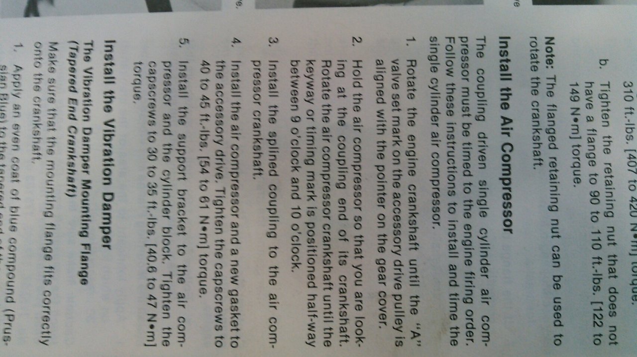

    I thank that is what you were looking for but I really struggle to post things at times. KIMG1657.jpeg It came from this book.
    The fuel pump is not timed! The compressor will work anyway as long as it is bolted up. Timing it to the engine reduces rattle in the gear train. There is a jack leg way an oid timer taught me on the side of the road but I would try to go by the book first.
