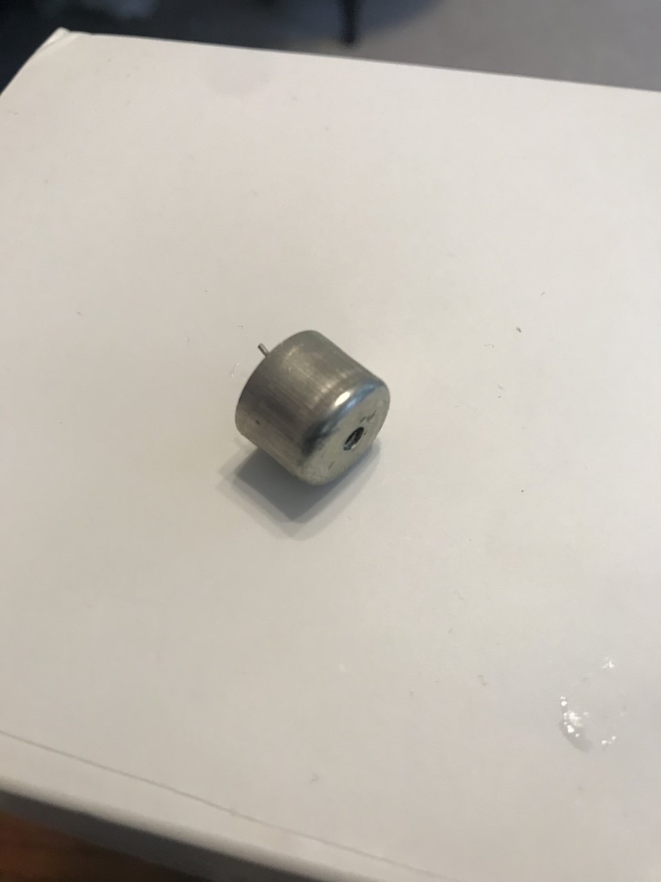

    This little inverter finally gave me fits after years of service. It started making a very loud whistle. It started as a chirp on occasion and went full blown ludicrous a few months ago and the fan stopped.
    I tore it open today and discovered that the main control board is back feeding through a piezo speaker making me think a diode went bad. Whatever the case I desoldered the piezo speaker and everything started working again and no safety fuses or capacitors blew. Very strange but the chinesium is fixed and working now.
