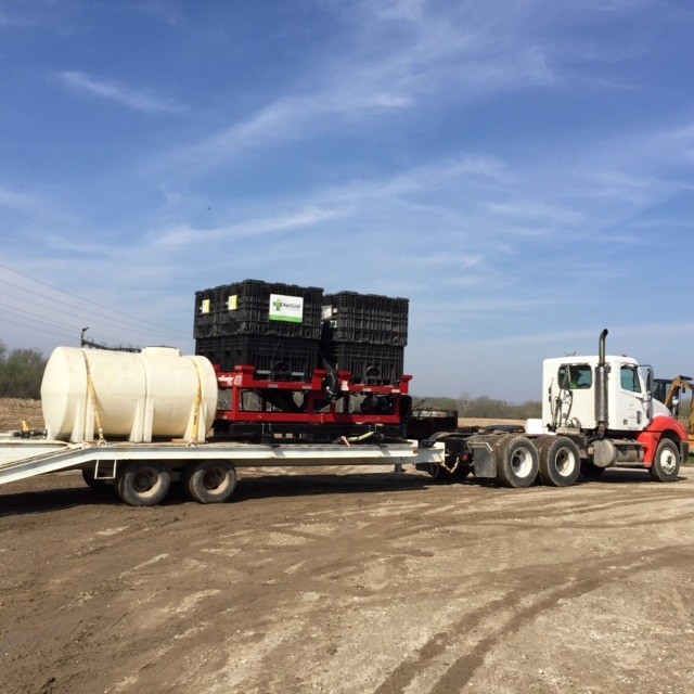

    Something like this...

    Number 5 may not be accurate if he is pulling a trailer like the picture, as it is still a semi trailer, a portion of the weight borne by the tractor. All the tongue weight is on the drives, but none on the steer. If he is pulling a trailer like a 28' pup, then you are right.

    True, but then he put a picture of a pintle hook semi trailer. I should have phrased it in a way that added to your answer instead of taking away from your answer.
