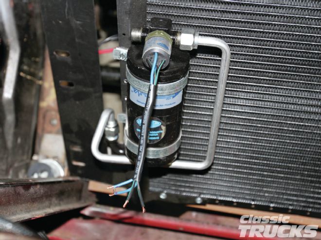

    Probably the trinary switch is bad. This is what makes the unit cycle on and off when the pressure is too high or too low. You can Google a picture of it. It's usually near or on top of the air dryer. They have a connection that's really hard to get on right. The shop may have replaced your air dryer and not put the connector back on good enough. While your truck is running and the AC compressor is not kicking on try putting pressure on the connection on top of the trinary switch.
    gunner76 Thanks this.
