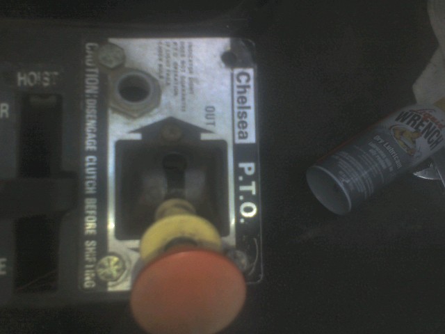

    I got the truck in and everything is ok so far. I notice a few leaks here and there but nothing major that I have come across at this point. This is my first truck.
    I have tinkered with the switches and have figured out most things with the excpetion of a few.
    1. The PTO and dump bed controls do three functions. If you pull up and push down on one control that lets air out when you push down it unlocks and locks the gate from what I can tell. The PTO switch itself says in or out. My question is to engage the PTO to raise the bed do I switch it IN or OUT (the light is missing) and once I put it in the correct position do I put the truck in drive? The truck has an automatic tranny so I'm not sure what I should be doing to try to lift the dump bed. The third lever on the assembly is a lever that allows you to raise or lower the bed but its locked on place so I'm not sure if that is because I need to unlock the bed somewhere or its because I'm not engaging the PTO properly.

    When the PTO is IN it is engaged to dump the bed.

    Is there a button in the middle of the raise lower handle? Push it in, hold it and the raise it or lower.

    There's a knob atop the lever... you might have to push down on it in order to get it to be able to move. Can you post a photo of your PTO controls?

    I agree, some local guys around here run 13$ a ton. Take a picture of your PTO and bed controls. Im guessing you have to push a button down ontop of the bed controls to get them to move.

    The Power Take Off (PTO) drives the hydraulic pump, and it is either going to be on or off. If it is not engaged when the switch is "out", then that would be off. Generally, air pressure will engage (turn on) the PTO, and spring pressure will disengage (turn off) the PTO.
    You should have another switch which controls the pump...also probably an air switch. This switch should normally be in the center position. Move the switch one direction and the bed should go up (if the PTO is engaged). Move the switch the other direction and the bed should go down. You will want to make sure when you lower the bed that the pump is off. Store-bought controls automatically disengage the PTO when you lower the bed. If yours is rigged up using generic switches, you will want to be sure to disengage the PTO prior to lowering the bed to avoid damage to the pump.
    Here's what my store bought controls look like:
    When I am driving: PTO is off. Control is in "hold" position:
    When I'm ready to dump, I position the truck then engage the PTO:
    Then, I raise the bed:
    When the bed is all of the way up, I turn off the PTO and ease the truck forward until I'm clear of the pile and the bed is empty. Then I lower the bed:
    When the bed is all of the way down, I move the switch back to the "hold" position.
    That's an overly simplified "how-to" on what the controls do.
    I've never driven an automatic transmission, but back when I was driving wreckers, a salesman was showing off a truck with an auto. In order to engage the PTO, he said to put the transmission into drive. Then engage the PTO. Then put the transmission back into Park. The process is similar in a manual shift transmission...you want to have the truck stopped and put the truck in gear to make sure the gears aren't spinning before you engage the PTO, otherwise it is a harsh engagement and you run the risk of tearing things up. There might be a lockout mechanism which prevents you from engaging the PTO unless the truck is in gear and your foot is on the brake...but without actually being there to see the truck or knowing exactly what you are talking about, the best I can do is guess.

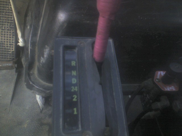

  11. cmb7684
    cmb7684 Bobtail Member
    29
    1
    Apr 26, 2011
    Metairie, LA
    Ok here are the pics I have so far. Maybe I'm missing something:
