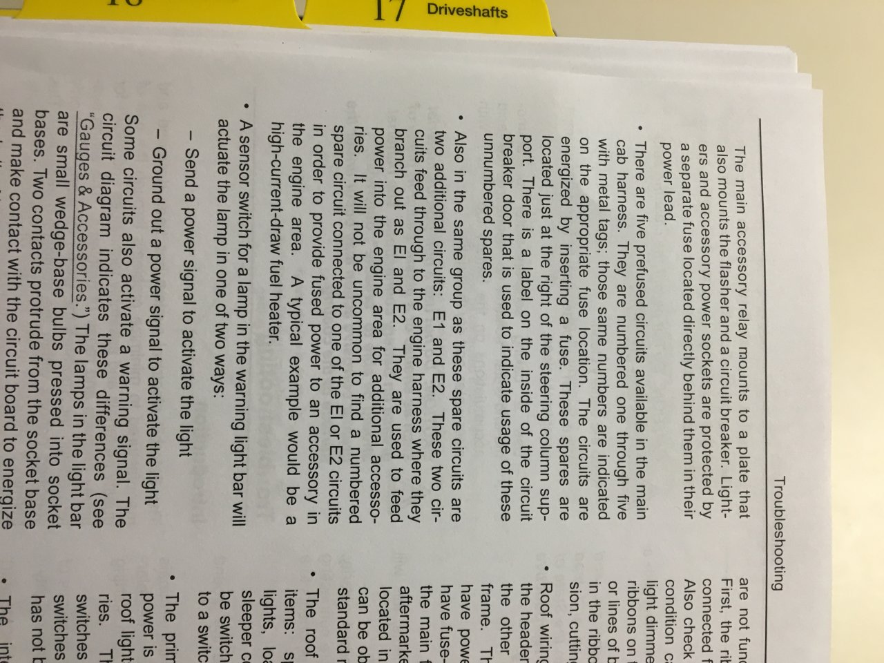

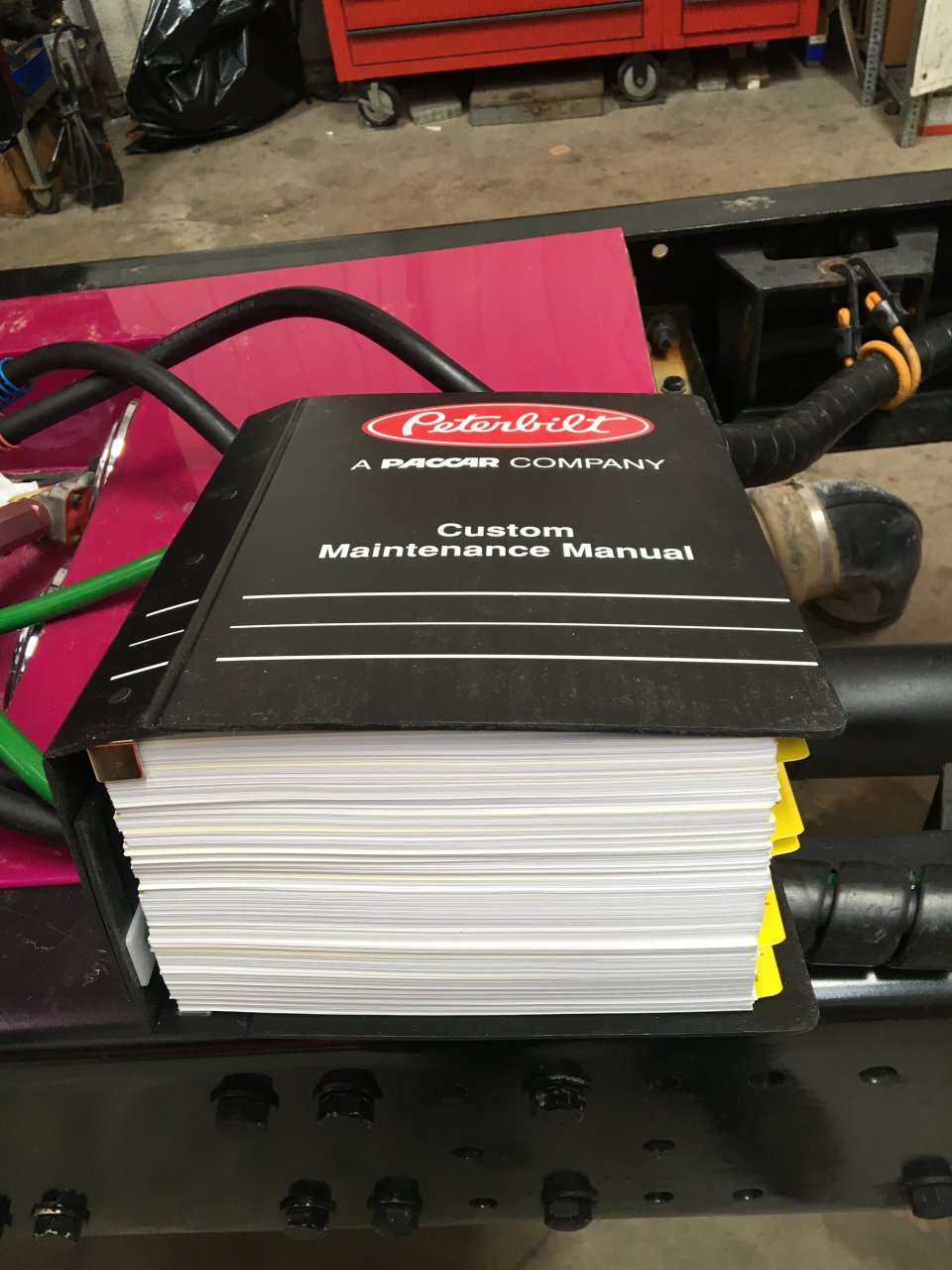

    I got my new book in today I'll look and see if it shows
    Oxbow Thanks this.

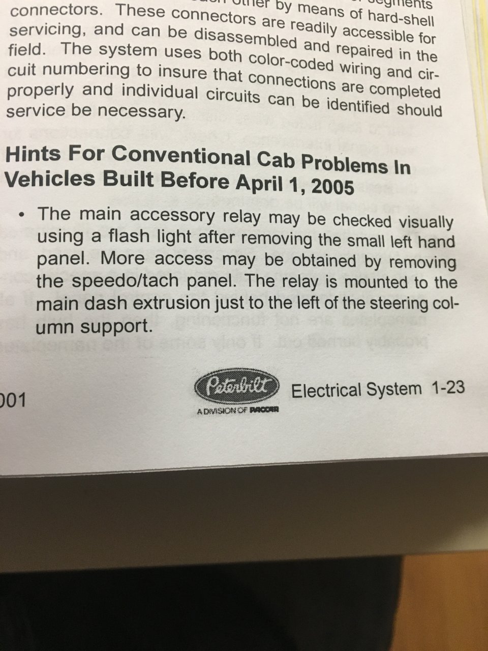

    Josh, I have the same book for my VIN and I could have sworn that's where I read what the fuses were for but, I can't seem to find it.
    I have a large print out of the supermiler link and I can't find it on there either. I don't think it is on there, I know the optional ammeter circuit isn't on there.

    This fuse block is to the right of the steering column and, the relay is to the left.
    The 5 prefused circuits are in the fuse box itself.
    I'm going down to the truck today to see if i can physically get in there to read the tag numbers on the wires that go to this fuse block.
    EDIT : I guess maybe E1 and E2 are in that small block because they aren't in the main fuse block. I can see the other end of E1, E2 in the engine compartment, they aren't being used for anything.
