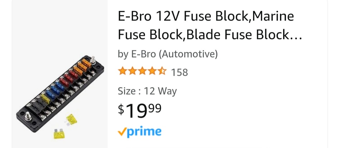

    Second question - Has anyone ever converted the buss bar over to today's blade type fuse? I attached a picture of an example.
    Rideandrepair Thanks this.

    Our little FL60’s had the same setup and in 25 years and over a million miles the only thing in the box I had to replace was the flasher and the hvac relay. They'd last about 3 years. Used to pull the fuel system fuse that Cat required out of it when left parked in a sketchy place as an anti theft device.
    JoeyJunk and Rideandrepair Thank this.
  10. Big Road Skateboard
    5,695
    29,706
    May 2, 2021
    Why would you? No, never have and never seen it done. I wouldn't, personally

    I didn't realize the original setup was so reliable so I'm not going to do it.
