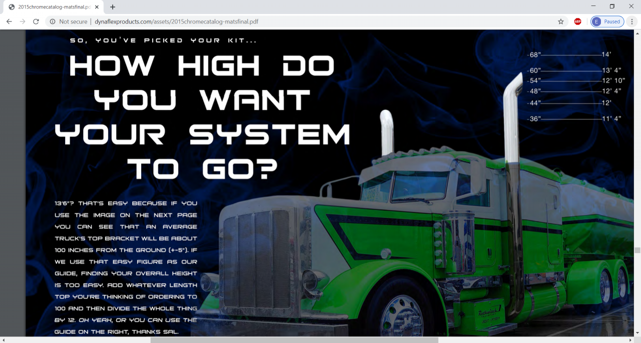

    after searching threw a few dynaflex pdf's i found this one. that makes a lot of sense. so basically your spool section should be the length of the centers between your cab brackets and then the length from center of your top bracket determines your overall.
    i don't know why this bit of information isn't in more places. iv spent a fair bit of time trying to figure this out already....lol
    now if they could just show how the pieces slip over each other. if the top slips over the spool fine tuning the overall should be pretty easy.
