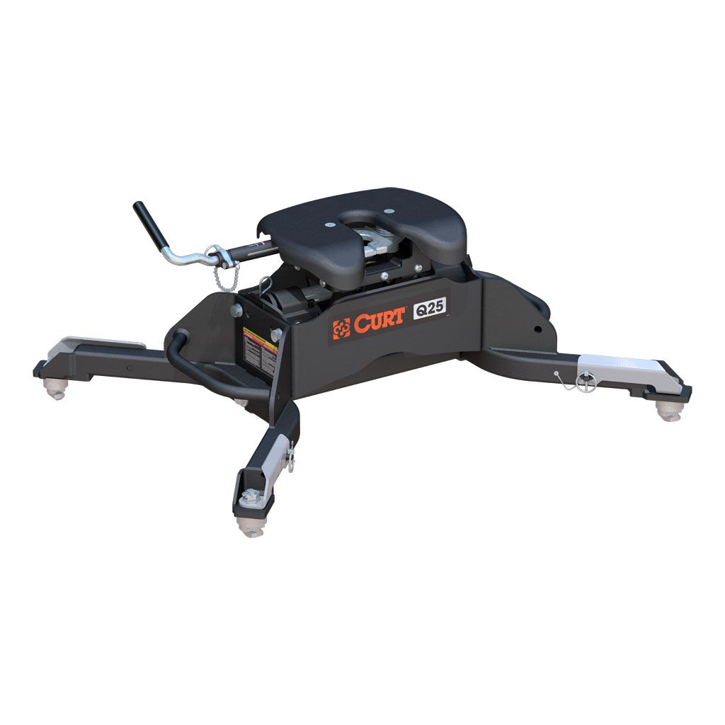

    Hello I'm sorry if this topic has been beat to death but I searched it and couldn't find much. Which is better / safer for a car hauling operation with a dually pickup truck fifth wheel or gooseneck? Trailer is a three-car Coffman wedge. I know a gooseneck is a simpler design and I see a lot of guys running them but my truck is already set up for fifth wheel it has a Curt q25 in it would this be sufficient to pull that Coffman wedge?

    16049_1024x768_a.jpg This is the hitch I have. It has alot of pivot side to side and a little front to back. Would that be a 4 way pivot?

    If it moves side to side and front to back its a dual pivot. Can still work just gotta be careful with a heavy car ontop and a tight or fast curves.

    Yeah my main concern was rolling. Do you suggest a particular model fifth wheel and do you use fifth wheel or gooseneck?

    You might be able to block the side to side pivot with rubber blocks or some such thing.

    Rubber blocks won't last long.

    IMO, it really depends on what kind of car hauling you plan on doing. If you plan on doing rough road placed like the oilfields by moving rental trucks, you may want to consider goose-neck to have more flexibility when on uneven surfaces. Otherwise, fifth wheel is usually the ideal option for blacktop only use. Avoid L-R pivot as the others have mentioned. Another note is the advantage of not dealing with chains cluttering around your hitch, especially if you have to switch trailers or just unhook a lot. Landing a 5th wheel is far easier than a gooseneck.
    I can't say that curt 25k will be adequate, assuming everything else is within ratings, you should be good to go. Just remember to keep everything within safe margins, and drive carefully. I see a lot of rolled wedges at sharp highway exits.

    Just remember almost all flipped-over hotshot trailers are 3 car wedges. 99% of those happen because of driver error and the driver being too lazy to move the top cars back down to put weight on the trailer axles after delivering the one on the back.. Facebook HS group is filled with 3 car wedges laying on their sides..
    You do not want a side-to-side pivot and make sure to move every car back no matter if you are just driving 5 miles down the road...
